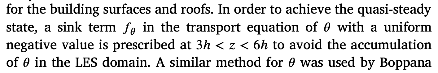

Thanks! Sorry for the late reply. I've been exploring a method involving controller to dynamically adjust the momentum source term based on the difference between target mass flow and current mass flow at inlet. This approach seems quite similar to the one you provided. I will compare these two codes.
Additionally, I have encountered another issue regarding adding the thermal conditions in these streamwise periodic cases. In my case, the air temperature remains constant at 292K, while the ground temperature is 332K. I've applied the Boussinesq approximation to account for buoyancy effects. However, when using periodic boundary conditions, I've noticed a gradual increase in temperature above the canyon due to heat accumulation. I've come across papers suggesting the use of a "sink term" to mitigate this issue, but I lack detailed information, as shown in the attached picture (https://doi.org/10.1016/j.buildenv.2022.109971).
I wonder if there is any available code in code_saturne for implementing a heat sink term or any thermal source term code related to addressing this heat accumulation issue. Any information or guidance on this matter would be greatly appreciated. Thank you for your time in advance.
Ximeng
Ximeng

The cs_user_source_terms can handle both source and sink terms, so you can use it for this.
The most difficult part here is probably computing/measuring how much heat is accumulating, so as to know how which value to assign to the source term.
A relatively simple solution might be to compute the total enthalpy in the domain at each time step, compare the values between 2 successive time steps, and define a feedback sink or source term (probably with some relaxation) to try to compensate.
