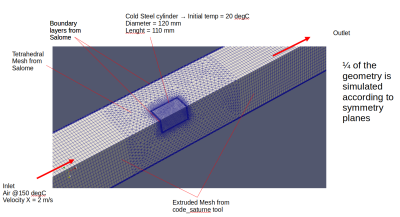

Re: Conjugate heat transfer of simple geometries - comparison with exp data
Sorry for the lack of information of my previous post
The case:
To resume, I want to simulation the heating time of a steel cylinder in air forced convection ambiance (at different velocities), the natural convection is neglected.
I have already done simulations with CHT OpenFoam solver and experimental measurements. (See my first post with the results)
I want to use CS for comparison and use it in the future because of the GUI and all the user friendly tools you have developed with CS.
The strategy:
First I calculate the stationary air stream with air parameters fixed at 150 degC (rho = constant, conductivity = constant, Cp = constant). The initial temperature of the steel cylinder is taken at 150 degC to improve the convergence speed.
Secondly I use as checkpoint the frozen flow and measure the transient heating time of the steel part, initial temperature of the steel cylinder is 20 degC.
The simulation parameters:

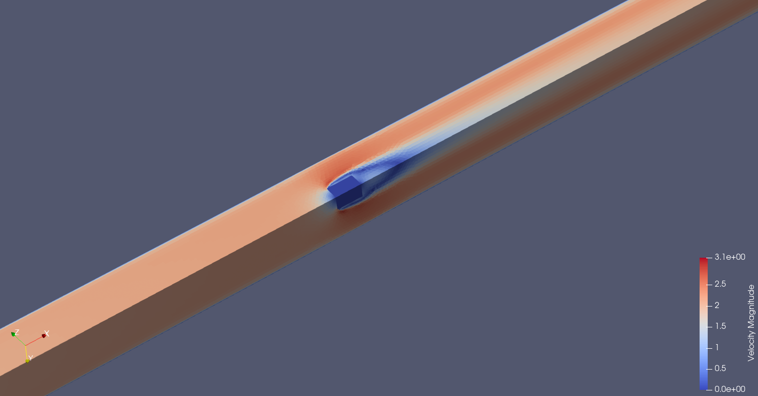

Please see the Mesh + velocity results to have a better understanding of my case.
Turbulence parameters are:
Re number = 8200
y+ = 1 is 0.0002 m (my first cell BL is 0.00017 m)
I choose kwSST with y+ around 1 (all y+ option) in stationary simulation with conservative parameters.
- First question about convergence of the air stream simulation:
I obtain some results but the convergence is not achieved. I use monitoring points in the fluid domain and I see that the values are constants after 400 iterations. See the convergence image attached.
I run this case on different meshes density and it gives the same characteristic values of velocities, k, omega etc...
Should I conclude that the convergence is reached ?
The case:
The strategy:
Re number = 8200
