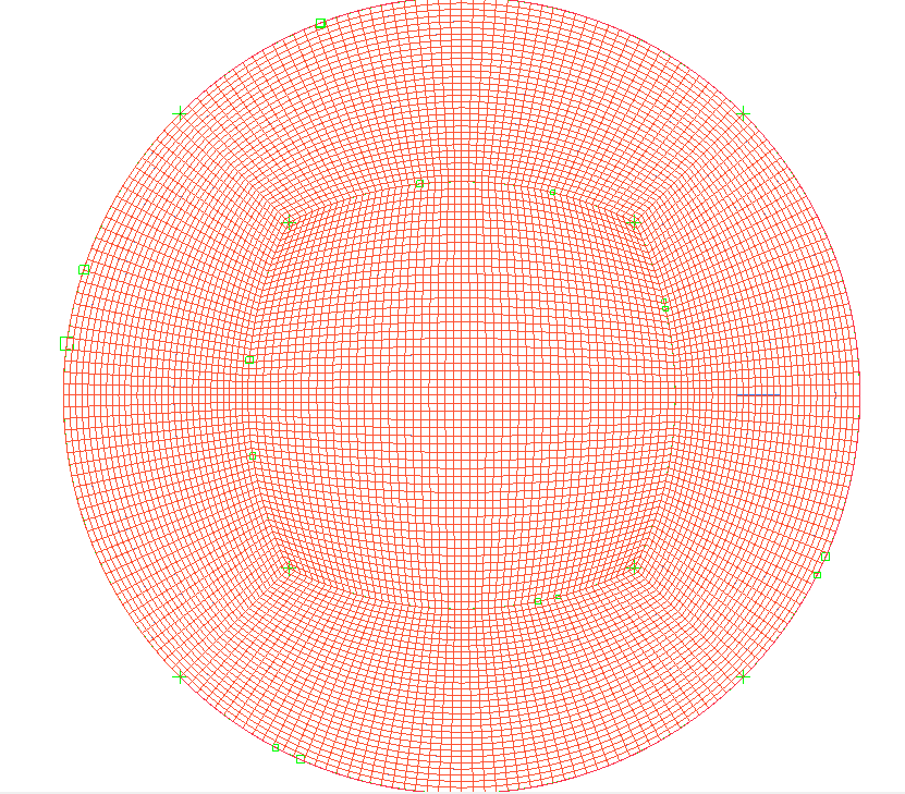

I showed your case to Sofiane today, and he beleives that the issue is due to a too strong chenge in cell size in the junction of you O-grid mesh. Zooming on the mesh, you can see that the cells are close to 10 times less thick just ouside the center "square". So using a less refined mesh in that area, to ensure a smoother cell size transition should help. Again, this is due to the fact that filtering is done only by the cell size, as we have o explicit filter (which would be useful but not trivial to implement).
So keeping the same refinement on the outer boundary (wall) of your mesh but thicker cells at the junction with the central "square") should help.

Hi Yvan,
I have modified the mesh and trying to make it uniform in all the direction (please find the attached file). However, the solution still have artefacts. please have a look and give your view on this.

Yes, I see that each time you improve the mesh, the artifacts diminish, but do not dissapear. The behavior confirms Sofiane's analysis, which is (summarily) that changes in cells size lead to changes in filter size, influencing the solution, but besides implementing an explicit filter (which would probably be very useful, at least as an option, but not necessarily a trivial undertaking), I do not have any "miracle" solution. If you do want to invest time in developing an explicit filter, I can try to assist, but I will also need to involve colleagues, who would probably thing this is a good idea in principal but might have other more urgent matters to handle, so I cannot guarantee anything, though I could at least get suggestions from them (and going this way depends on how much of your own time you can invest here).
