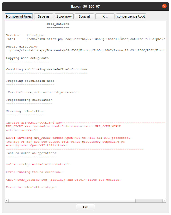

I finally installed a new build of CS from Git in the debug mode (with debugging symbols) and re-ran the calculation. However the output looks similar to the previous without debugging. Which data should I provide to find the bug?
The error message is different as well. The main calculation won't start.

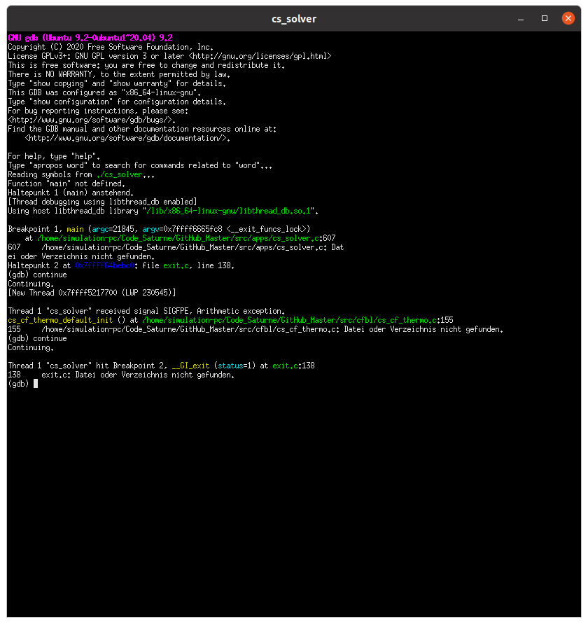

Hi,
here is the output from gdb. So is the "interesting line" number 155? I have never used gdb before. The German message is "File or directory not found" and refers to the cs_cf_thermo.c. The interesting thing is that the folder "GitHub_Master" was my source folder, which I already deleted. However, the main calculation runs fine without the stiffened gas model (see gdb2).
Kind regards,
Christopher
Kind regards,
Christopher

- Posts: 4299
Re: Underestimation of velocity, compressible model
I'm not very familiar with the compressible module, so I may need to check with another developer, but looking at your debug/gdb screenshot, it seems you have a crash line 155 of cs_cf_thermo.c.
You could reach that line typing "up" multiple times in the gdb prompt, but in any case, looking at the matching code, there is a division by cv0 and t0, so I suspect one of the two has not been defined and is set to 0. Could you check those (both in the GUI, user functions if you have them, and setup.log for confirmation/cross checking) ?
