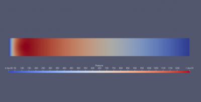

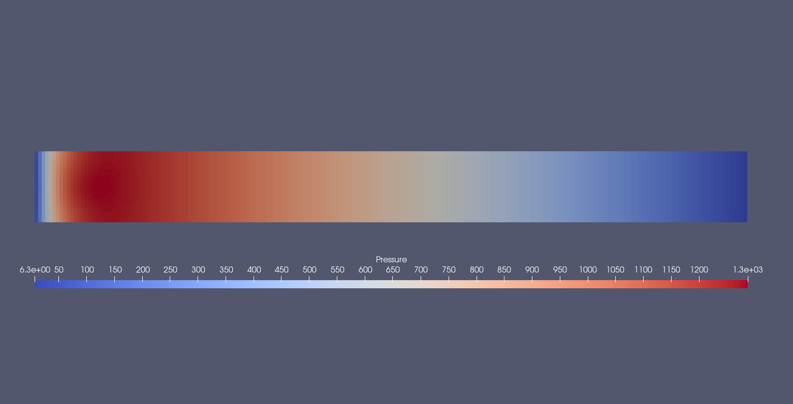

However, looking at the result
there is an unexpected result.
Why is pressure velue around [6.3-1300] in the picture, even though I set them as 100050Pa and 100010Pa in subroutine?
Mohammad
Posts: 114
Joined: Thu Oct 25, 2018 12:18 pm
Re: Dirichlet boudary condition for inlet and outlet
Post by Mohammad »
The value set in your codes is total pressure while you are looking at relative pressure in the picture.

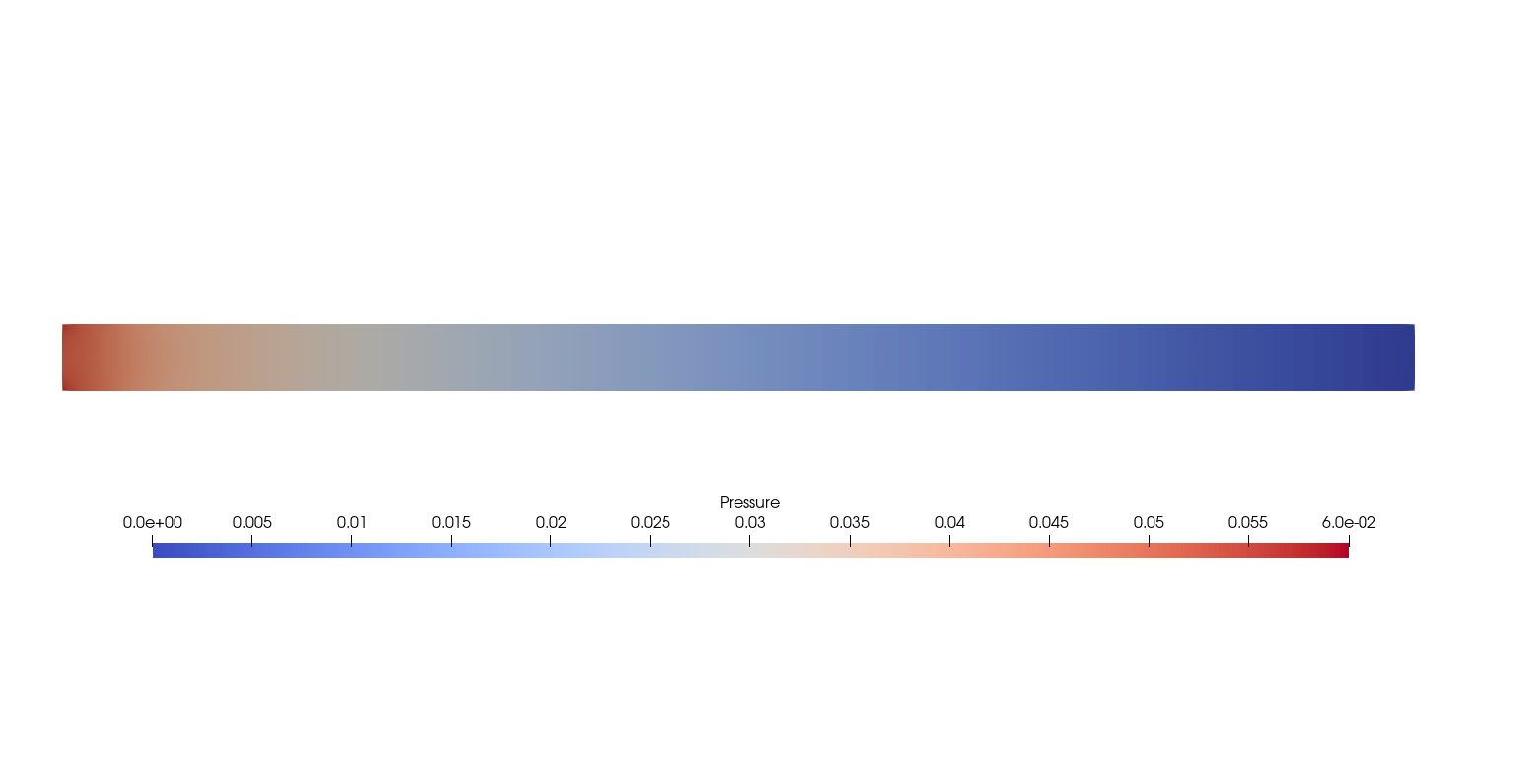

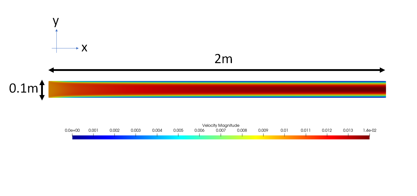

Now, I am trying 2-dimensional channel flow(x=2m, y=0.1m, z=0.005m(1layer)). For z direction, Symmetry condition is applied. The geometory can be seen in the below picture.
When imposing velicty inlet condition (u=0.01m/s) at the inlet and normal outlet condition (which can be set by GUI) at the outlet, I got the above result, and I got the0.06Pa pressure difference between inlet and outlet in the below picture.
Therefore, what I want to do next is that I want to get the same velocity profile as can be seen above picture by imposing pressure differece 0.06Pa between inlet and outlet.

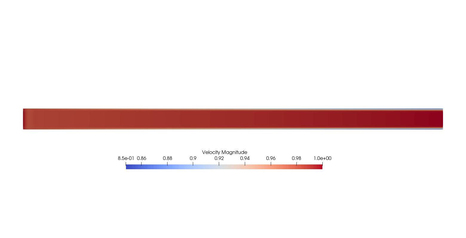

However, although I was supposed to give a correct subroutine code below
call getfbr('inlet', nlelt, lstelt)
do ilelt = 1, nlelt
ifac = lstelt(ilelt)
icodcl(ifac,ipr) = 1
rcodcl(ifac,ipr,1) = 0.06
enddo
call getfbr('outlet', nlelt, lstelt)
do ilelt = 1, nlelt
enddo
I cannot get the result, which I want.
Looking at the result,
for the velocity, velocity magnitude is very large (around 0.8-1.0m/s, idealy this should be around 0.01m/s) like this.

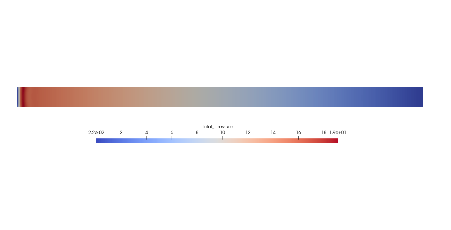

For the total pressure (which can be set by subroutine code), non-physical profile was appered.
Could someone give me tips how to get good result?
If there are mistakes in subroutine code, could you teach me?

For the total pressure,
the result is like this.
This is non-physical.
