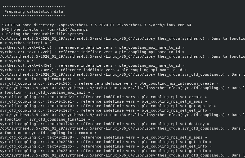

When my user tried to make a coupled simulation, the directory creation works, GUI interface also but we have an error when we launch runcase (see picture attached).
Vincent

Vincent Doré
- Posts: 4302
Re: Syrthes CFD installation
Was code_saturne and PLE installed with MPI support ? This is necessary for the Syrthes coupling.
