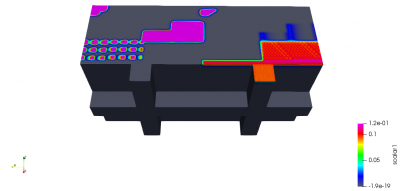

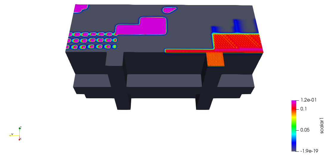

The coupled simulation now runs completely however I have encountered another issue with my scalar parametrization. I used the cs_user_mass_source_terms.f90 to select rows of cells and add a scalar emission. I have used a similar example before and had no problem. Instead of having cells emitting scalars along the center of the domain for some reason they are located at the first row [img][\]. I have no other initialization parameter neither. Could you please check this problem? Would you need me to send you the complete case?

For the other issue you have, I would indeed be interested in the full test case, but if you have a smaller version of the mesh, it would be even better. I suspect that the indirection for mass source terms is not taken into account here, or overwritten (explaining why the source terms are not added in the correct place), but testing it on the same case would be simpler.
In the meantime, if you can print the values of icetsm (or at least the first 10 values) in the second and different passes of cs_user_mass_source_terms.f90, it might help to confirm this.
