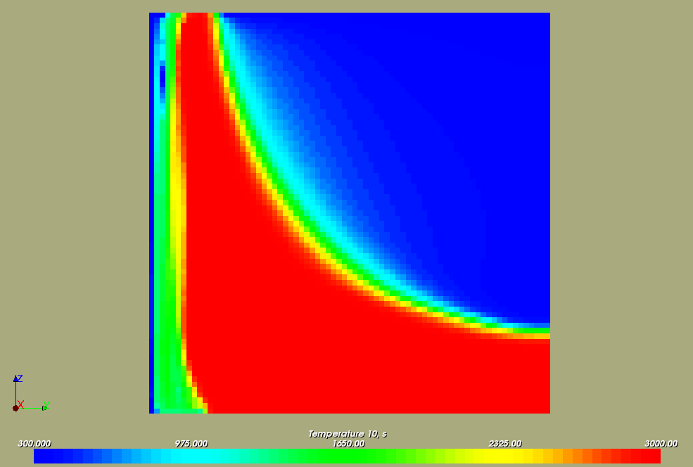

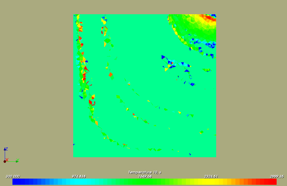

Fabien852
Re: How to use the gas combustion module ?
You were right, I made a comparison between Tetrahedral and Hexahedral meshes and
it appears that the Tetrahedral mesh doesn't work correctly, I attached pictures of the test.
I took a cube :
Above : you have the air inlet
Left : the gas inlet
Right : Outlet
I took a cube because this is the only geometry that I succeed to use with Hexahedral mesh.
So, to do things well, I will make a new topic to learn how to use the hexahedral mesh.
Fabien
I took a cube :
Right : Outlet
Fabien
