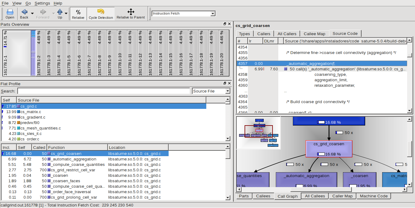

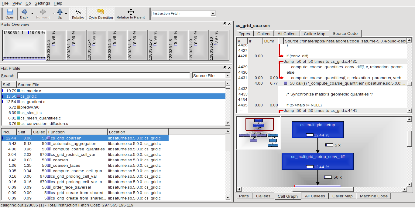

Based on your post I assume that you are running the test in a single machine (not a cluster) with 40 physical cores, so you don't have an overhead due to network communication. I have run some tests in order to measure the scalability of CS and the use of flat MPI option gives the best result (lower time), than using a hybrid alternative, despite the memory consumption.
Trying to understand the performance difference between flat MPI and hybrid, I have run the test cases using callgrind, cachegrind and massif from the valgrind suite tool and I found that the load in each thread was unbalanced. Always the Thread_0 has more load than the others (I attach two figs). Going deep inside the code, the operations of coarsening of the multigrid solver are only executed by the Thread_0 due to there is not a mesh partition. When you add more processes this work is distributed between these processes. When you run flat MPI the load is perfectly balanced between the processes.
This is a brief explanation about what I found, I'am not 100% sure if this appreciation it is correct.
