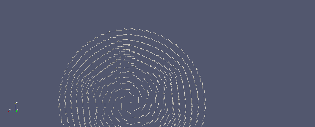

It doesn't matter what angle I choose, I have the same results as shown in figure 1. Also it doesn't matter what velocity or volumic flow rate I set in GUI, it doesn;t change the values that I get.
Can I set the volumic flow rate in cs_user_boundary_condition.f90 too?

Regarding the velocity components calculation. I used other math, intended to cope with arbitrary inlet face orientation. Also, I made my "plugin" quite long ago so I don't remember details. I only can say that I found the general coordinate system rotation formulae on the Internet. If you only need the swirl-type BC you can use my program (fill the Excel table attached to my previous message, export to CSV and place in DATA directory, don't forget to copy the program to the SRC).
Regarding volumetric/mass flow rate. No, you can't. Your BC scrip overrides GUI settings. Also, from the physical standpoint, you cannot set velocity and flow rate simultanously. If you set the velocity profile, then the flow rate will be given by the surface integral of Rho*Wnormal.
Concerning errors reported when you run calculation, I think, Yvan will help you, or you can ask you IT specialist, or take a closer look to what happens (inspect the RESU subdirectory, or direct the output to GUI window in GUI settings, use only one process for testing etc; there should be some issue because, in normal way, it just says "Saving calculation results").

In GUI I can set a volumic flow rate and then set a direction using user profile. I tought that if I set a volumic flow rate in GUI and then write the same formulas in subroutine then rcodcl(ifac,iu,1) would be the equivalent of dir_x for example.
About that error, I get it only when I use subroutines, it doesn't matter how many cores I use. I just get this error and I have to use run_solver which is located in RESU/-mycase- and then I get all the files and postprocessing folders etc.

@Antech "b" value should be the angle presented in the Picture1 attached.
