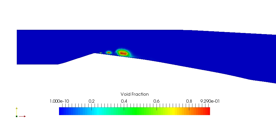

As Benoît mention the problem was in the pressure. In your case if you set a
and the outlet pressure according to the cavitation number
you will get the cavitation of the fluid at the throat. I have run you case with a dt=5e-6 [s] and the results are reasonable according to the paper "Development of algorithm based on the fractional time step for the simulation of cavitation".
Also I notice that the dimensions of your venturi are smaller that the used in this paper, so you have to be careful if you want to compare the results, because you Reynolds number will be different. It is a very interesting case to be solved, there are a lot of experimental information. Perhaps can be created a tutorial with this case, like the Shear driven cavity flow.
I attach a figure of the void fraction being advected.
Luciano
Luciano
