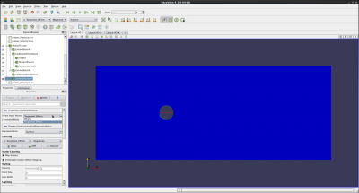

Im sorry for my last post, the surface vector filter doesnt come out until the cell data is changed into point data. I dont know why that is..
So i have use the surface vector filter for my boundary and I am not sure what is it returning can somebody clarify to me what does the surface vector filter do.
I also realise that there are two option that i can twich
select input vector: efforts or tangential efforts
select constrain mode: parallel or perpendicular or perpendicular scale
can somebody explain to me what this do?
