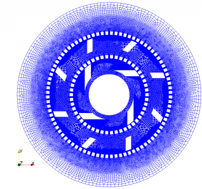

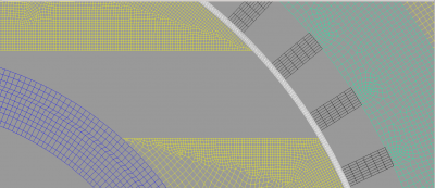

Mahmouddwikat
Re: Coupling in code_saturne
I have reduced the mesh refinement close to rotor, but im still getting same error.
I took two more snapshot for my mesh.
The empty spaces close to yellow mesh represent rotors and the rectangular shape close to the black mesh represent stators.

- Posts: 4286
What is the white section ? rotor, stator, or mixed ? It still seems muhc too fine compared to the rest.
The rotor-stator functionnality in Code_Saturne assumes that boundary faces do not change, so they are not updated. In your mesh, some faces could be boundary faces in some positions, interior faces in others, and that is not currently handled.
If the white section can be split in 2, with 1/2 rotor, and 1/2 stator, with one cell thickness in each case, your calculation should run better (assuming this is indeed where rotor and stator sections meet).

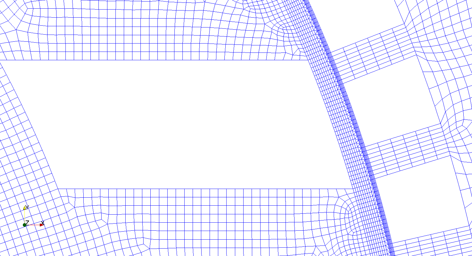

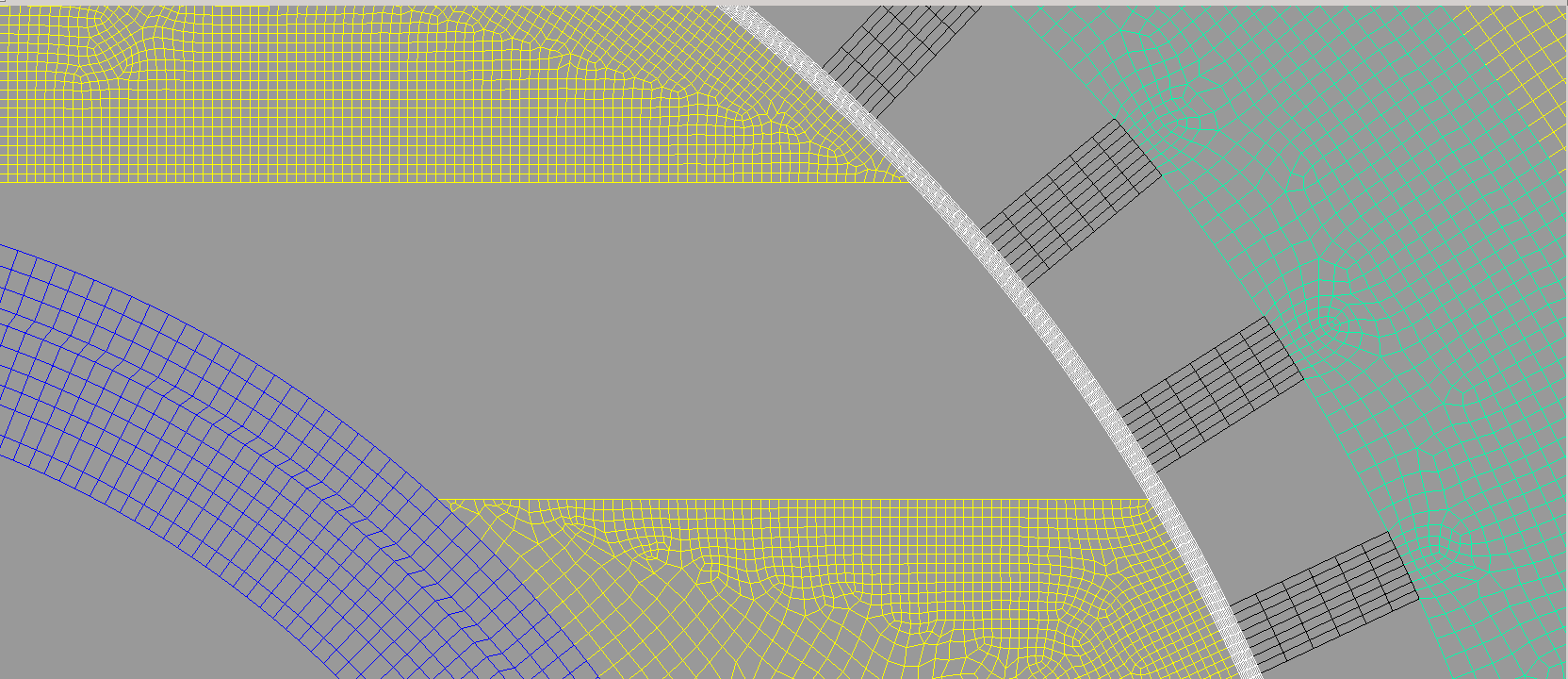

Mahmouddwikat
The white section is the fluid gab between the rotor and stator.
I tried to run it for both frozen or rotating fluid.
- Posts: 4286
It is as I guessed. So following my advice from my previous post (split the gap mesh in 2, one half assigned to rotor, the other to the stator, and coarsen it) should help.

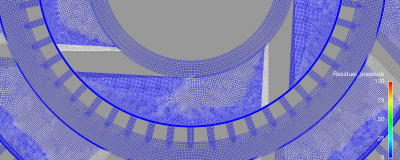

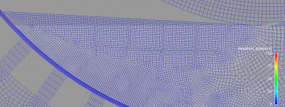

Mahmouddwikat
I have split the gap into a rotating and a frozen zone, I'm still getting the same error (high pressure residual).
I just visualise the error and compare it with original mesh (see the attached snapshots). You can clearly see something wrong at the interface cells (distorted!!) between rotating and frozen cells (the white cells as original mesh cells and the coloured one is the visualised results).
