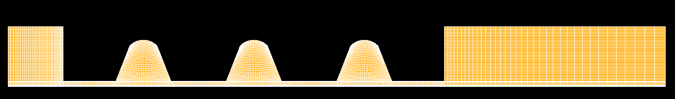

An example model with a similar configuration is attached below.
