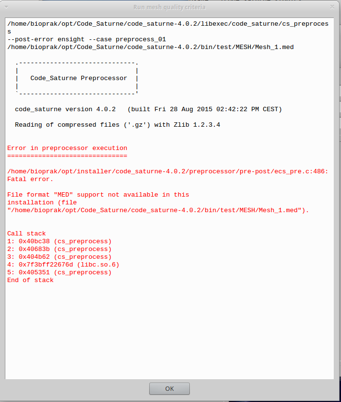

scotch no
libxml2 yes
The problem occurs once I try to add .MED file into GUI. It seems like the med library is not installed correctly. However, I have tried installation within the "standard" installation process as well as downloading and installing libraries separately. Same error (screenshot attached) appears every time.
Could you suggest what can be the problem?

Could you post the installation log files as recommended in the forum guidelines ? It will help understanding why MED support was not enabled correctly.

Thank you very much for your support! However, we have installed last Ubuntu version on our machines and now Code Saturne 4.0.2 is installed successfully.
