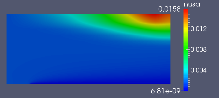

Hello, everyone:
I'm a newer in Code_saturne. Recently I want to simulate a case that 2D turbulent flat plate. The Re is 5 miilon and the mesh is download form NASA Turbulence Modeling Resource(http://turbmodels.larc.nasa.gov/). The RANS model which I used is S-A turbulent model. I have some questions about how to set boundary condtion. In GUI, have no farfield boundary condition, so I have to set Outlet boundar condition for the farfield boundary. In listing file, "Incoming flow detained for 132 outlet faces on 232" is usually found, I can't unstandard what meaning of this word. And near farfield boundary, the nusa is too higher. So, how to set boundary condition correctly? Finialy, I have no confident about how to simulate turbulence flow in Code_Saturne, maybe I use wrong parameter that set in XML file.
My English is poor, I wish I have explain the problem which I encounter correctly.

Thank Yvan very much!
Here I upload the cases which set up in Code_saturne. Inculde mesh, xml file, schematic of flat plate, and two post-process files.
a. In picture of schematic, as In GUI have no farfield boundary condition, I also set as outlet boundary condition;
b. xml file. I set two Reynoly numbers, laminar flow at Re=50000, turbulent flow at Re=5 million(The length of plat flate is 2);
c. for laminar(Re50000) and turbulent(Re5000000) are two results which I obtained.
d. the mesh is download from NASA website. I modify the name of boundary face groups as the oringal name is too long.
For laminar flow, have some problem at sym. And for turbulent flow, I don't have the correct nusa.
Regards
Yong Wang
Regards
Yong Wang

Re: The problem about 2D turbulent flat plate
There are 2 possible issues in your case:
- you have a very refined mesh near the wall. This is good for low-Reynolds models (the y+ near the wall is near 0.6), but maybe to refined for high-Reynolds turbulent models.
- you have very high CFL numbers. You could reduce the time step, or use a local time step (steady computation mode), to have a max CFL not higher than 20 if possible. Postprocessing the CFL the high values are near the plat inlet, probably where the flow is not quite tangential to the plate, and your mesh is very refined in the y direction there. A less refined wall would lead to better CFL values.
- on the laminar case, at the "outlet" before the plate, strong variations in velocity values mean there is a bad velocity-pressure coupling. Using symmetry instead of a "tangential" outlet before the plate would probably lead to a more stable computation.
I a not sure what the expected "nusa" value should be. Running a few time steps with k-epsilon, turbulent viscosity is important in the same "far-wall" region, but turbulent kinetic energy is higher near the wall.
Colleagues tell me there is a minor bug in our Spallart-Almaras model, but it should lead only to a small (subtle) error, not something easily visible.
