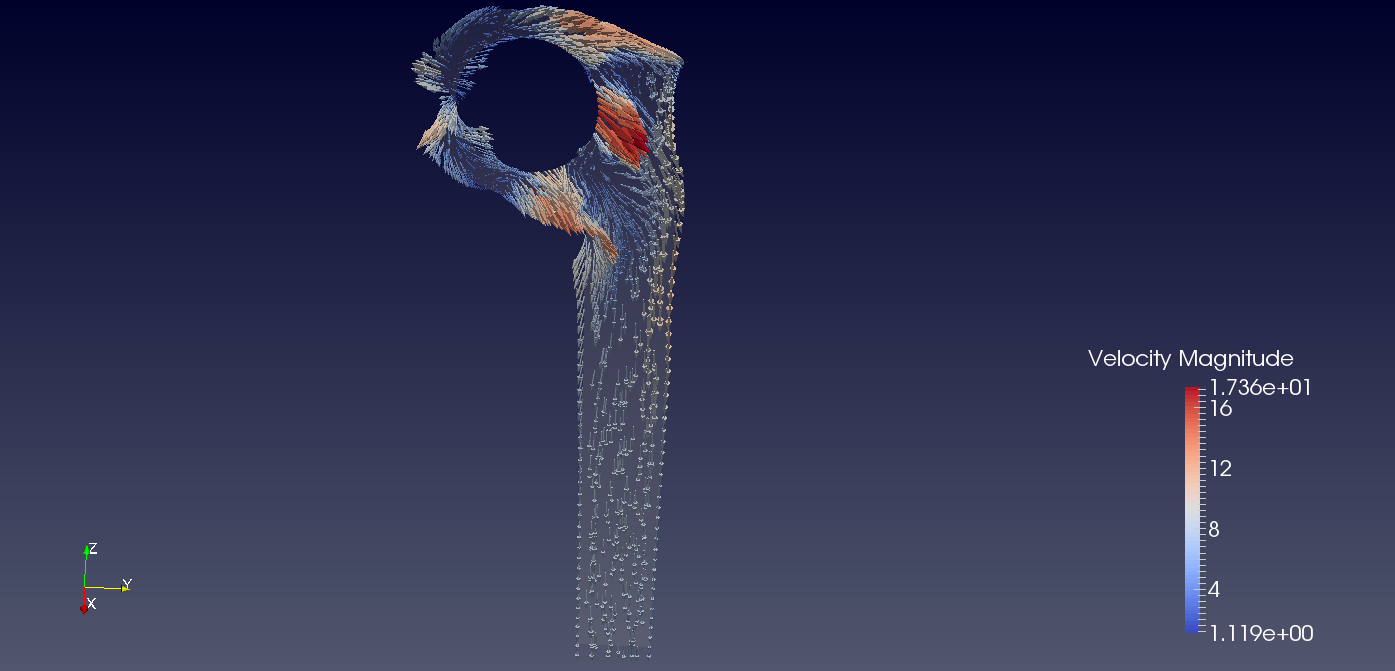

Thank you Antech for the tutorial...
This is what I can produce in the middle of the outlet pipe

Ccaccia73
Thanks, can you make the same picture for Saturne v2 results? IMHO, it's a good idea to set uniform scale for vectors (AFAIR, ParaView can do this).
The problem is that I don't now your case (what is physically in the domain, what are BCs, what flow patterns/features are typical for this device). I understand that the details are confidential, but only you can treat results right. I can only guess some things. I cannot do even a basic analysis of your case, but for my work tasks I always perform at least visual vector field analysis to check wether the results are "physical" and expected qualitatively.

Post by Ccaccia73 »
Here is what I get with saturne 2:
streamlines seem better, as posted before.

Post by Antech »
Ccaccia73
Thanks. Vectors look similar to Saturne-4 so they doesn't explain why streamlines are strange in version 4 results... In your place I would prefere to analyze the flow details with vectors in various slices, and, maybe, with streamlines from different cross-sections (near the problematic area). It's also often usable to set constant vector length (don't remember if ParaView can do this). I can't say more definitely because I don't know you case specifics.
