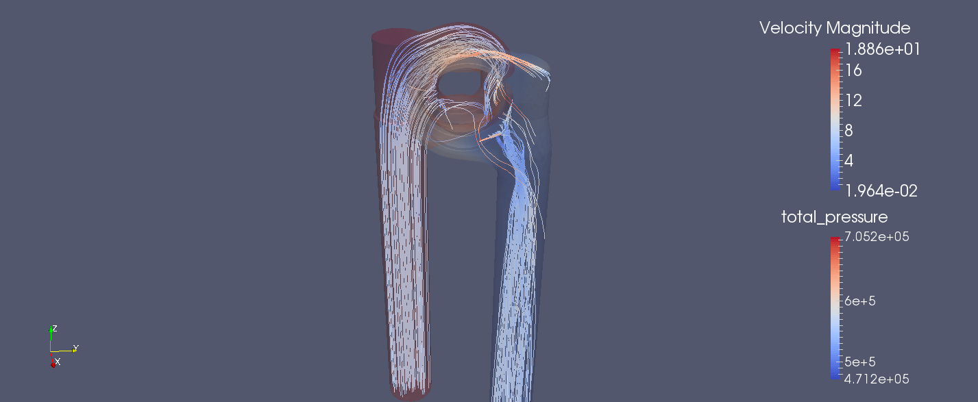

Did you change the maximum length for streamlines?
Comparison of Saturne 2 and Saturne 4 results
Re: Comparison of Saturne 2 and Saturne 4 results
No, all parameters are the same
You may try to incrase the streamline length (press the "gear" button in streamlines properties window).
I've already tried but streamlines stop always where you see.
OK, I see. What the vector (on slice) visualization shows?
Ccaccia73
Sorry, but I'm Andrew (Antech). If your question is about vector plot in my post, then you may compare vector flow fields obtained with Saturne v2 and v4. Anyway vectors will not end at boundaries like streamlines and you can see if there any non-physical behaviour of the flow in Saturne v4 results.
Are there streamlines started from the inlet? You can also use streamlines with volume seed and include all volume so you'll see the stream in "empty" region.
I did not check your xml files in detail, so I'll ask if you have mesh joinings in your case ?
If you do have mesh joinings, did you visualize the output to check that everything is joined correctly (viewing both he the joined parts and the remaining boundary after a mesh verification / mesh quality criteria run can definitely help here).
Antech, sorry, I've just confused names...
I think I'm not able to to plot streamlines with volume (only point or line source are permitted) and vector fields are plotted after streamlines (or I cannot manage to plot them starting from results.med). But I can use another seed: the first one is at inlet the second at outlet, they don't seem to join. Yvan, the mesh is a single med file, made with Salome. It should have been partitioned by Saturne. I remember that the output of Saturne 2 gave also "parallel domain", which I cannot find in Saturne 4.

I use default EnSight Gold format (results.CASE + field files) for Saturne results, so I'm not sure that suggestions below are applicable to MED format.
There is another stream tracer in ParaView that can operate on volume (press Ctrl+Space and type "stream" for fast search).
You can do that without streamlines:
1. Apply "Cell data to point data" filter to results file (this may introduce some uncertainity due to interpolation).
2. Create Slice or several Slices at desired coordinates.
3. Apply "Glyph" filter to Slice(s), select Velocity vectors, [v] orient glyphs. Set desired scale.
Sorry for offtopic.
Your streamlines look really strange, IMHO. I suggest you to verify the flow pattern (vectors), to compare it with Saturne v2 results before the pressure drop comparison.
About partitioning. Saturne 4.0.0. writes parallel_domain "field" by default! Maybe, something wrong with the case settings or so. Ivan will help you with it.
