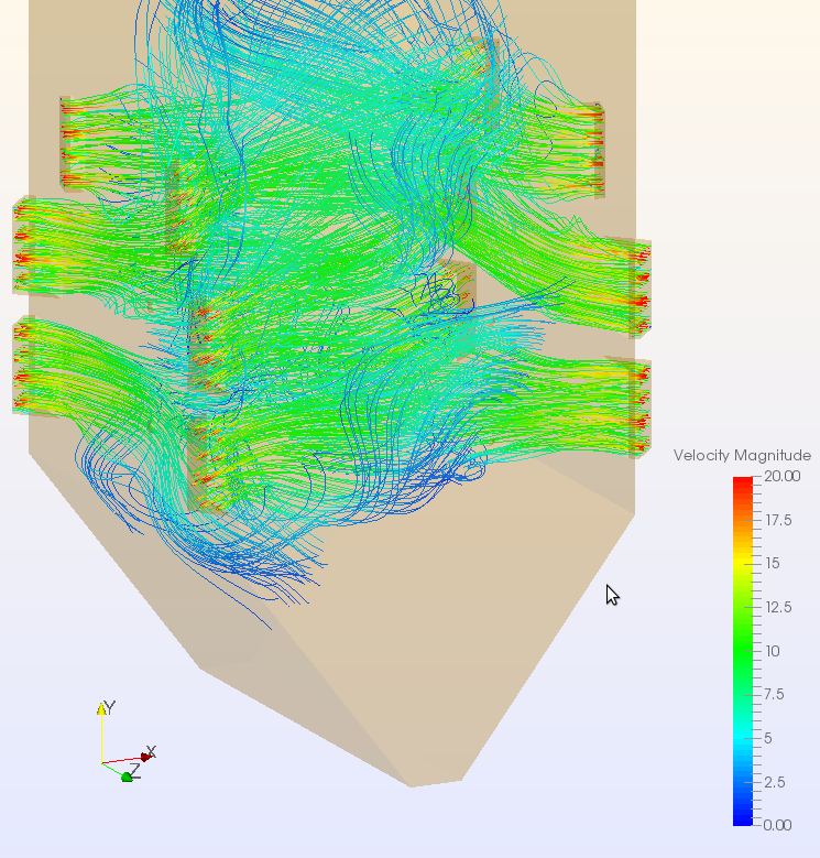

I'm continuing to test and learn Code Saturne on my PC. The basic level target is to be able to perform "pure aerodynamic" calculations on arbitrary, not very simple geometry (not a cube or cylinder) with adequate speed.
For test cases I chose an existing geometry of "tangential" boiler furnace (see attachment). Naturally, in tests it's just an isothermal cold flow with constant properties (defaults), but this flow is not very simple (not a flow in a tube e.t.c.).
Inlets are arranged in 3 tiers, each tier has 4 groups of inlets on two opposite walls. Inlet velocity is 20 m/s. At the top of the "furnace" is a pressure outlet PC (ambient). Other boundaries are smooth walls.

I attached the Saturne's listing for 5.7-million case, the case directory and a picture of streamlines from inlets (ParaView). Picture is for ~1-million mesh.

Tetra ~1 million cells, 500+ iterations. Streamlines from inlets.
