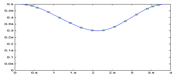

I am currently studying the flow in a wind tunnel (cf. picture).
I tried to use this turbulence model for a steady state but the results always diverge. I have tried different meshes and different parameters but it seems that it doesn't change anything. I don't know what I am doing wrong.

Your diagram has no axis legends, so I assume it's an inlet profile, but I can't be sure.
Please read the forum guidelines to see what Information to provide; with the litle you provided, I can only guess...
