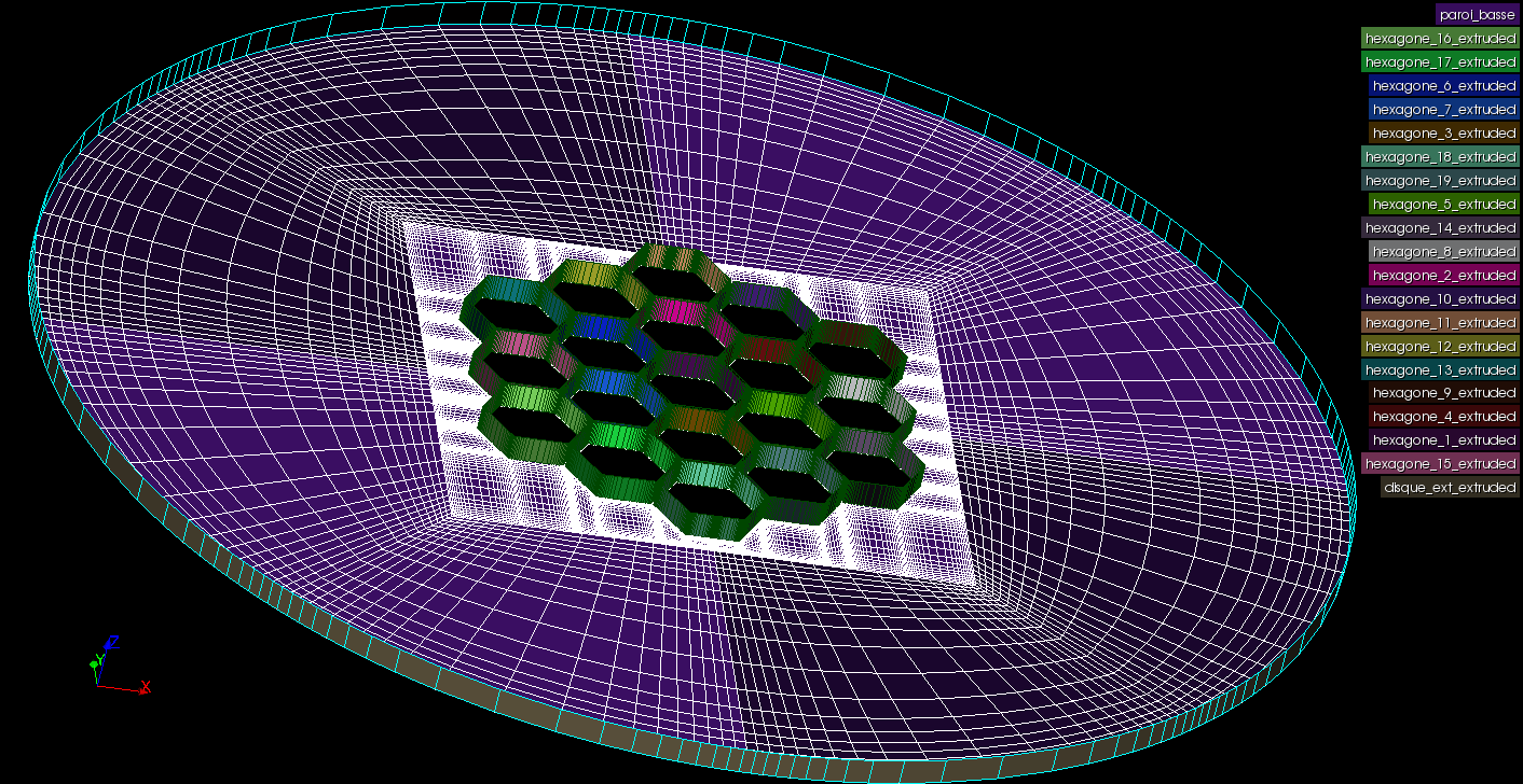

I want to simulate a problem of fluid structure interaction using the ALE method, the attached image of the mesh and groups. On the graph interafce I can not put negative values so that I can declare the initial positions and the positions of equilibrium of each internal structure, attached the ficheir . Xml. I tried to settle this problem is stating the boundary conditions in the attached file usstru.f90. But still I have the same error message in the listing file.

This seems to be both a bug in the GUI (not allowing negative values), and in the reader (not accepting an incomplete definition for BC_5, while this definition may be handled afterwards by a Fortran user subroutine, so checks should come later).
As values defined in user subroutines normally supersede those defined by the GUI, you may be able to work around this bug by defining complete (but false, with only positive values) initial positions and positions of equilibrium for all structures, so the the GUI file reader does not complain, then use usstru.f90 you defined to replace those values with the "correct" values.
