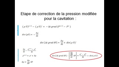

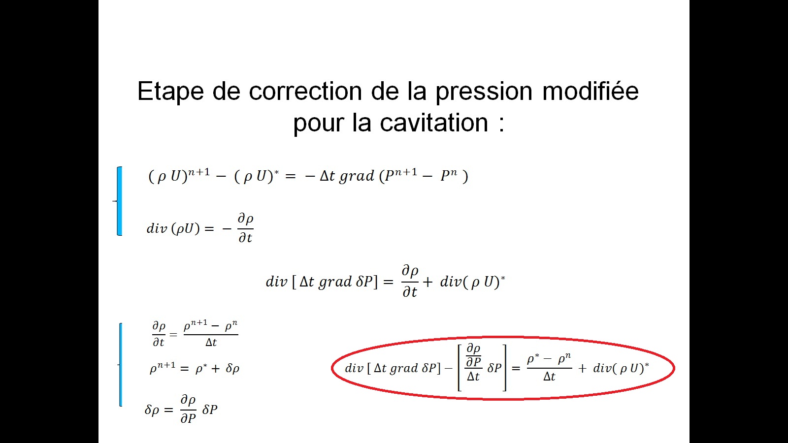

modified pressure equation.

Re: modified pressure equation.
Thanks for answering.
The system is as follows:
* state law to resolve the density and obtain (drho/dp).
* resolve momentum equation (preduv) using the new density.
* resolve the new pressure equation.
Find attached the modified pressure equation.
RC
