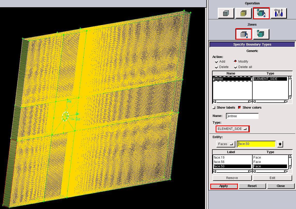

A possibility of your problem is the definition of solver in Gambit. In fact, you should  define generic solver in Gambit to have a support of boundary conditions in neutral file. To verify this problem you can read the neutral file with notepad or an other software and verify the number of boundary conditions and their name. After the selection of generic solver, you can select your boundary conditions on faces with Elemnt_side as type and after you define your real type in Code_Saturne or you can select a volume to define Fluid and Solid conditions in the second button of Gambit. You can see the definition in my pictures.

First of all thanks for your pictures. As I said to Yvan I will follow your approach of defining the BC as indicated in your first picture and I will get back to post the result.

Just to make the update. After defining the BC in Gambit as element_side everything was well imported in Saturne. It worked.
