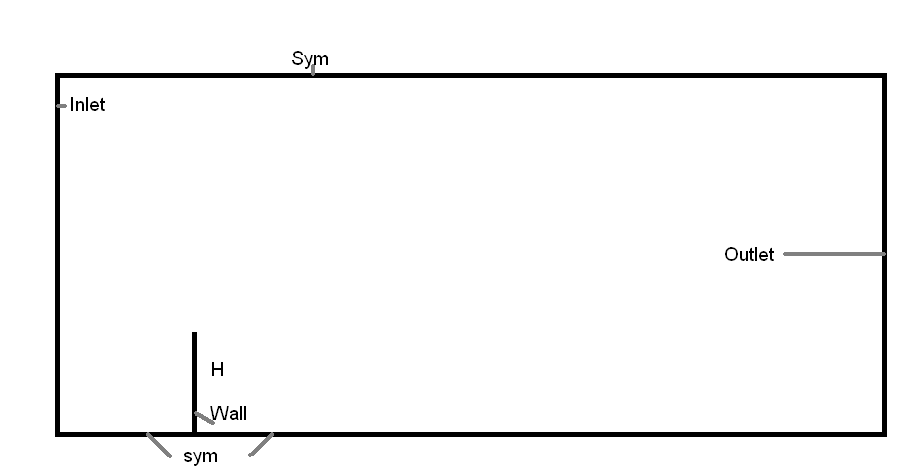

The main goal is to find the distance between the top of a vertical plate and the place where the flow isn't modificated by the plate.
I decided to construct a simple 2D geometry described after in attachments.
- (10.77 KiB) Not downloaded yet

Re: General issues with Code Saturne
The problem is that the flat plate you tried to mesh is not represented as a boundary:
You assigned groups to the plate, but the matching faces appear as interior faces (see the preprocessor log).
To have boundary faces with a thin wall, matching faces on each side of the wall must have at least one vertex which is different (they may be geometrically identical, but have a different vertex number). If you merged the 2 faces under Salome, you transformed a boundary to interior faces, albeit with an associated group (which culd be useful for postprocessing: Code_Saturne can't determine that this is a boundary simply because a group is associated, as that group could be useful for interior faces).
So basically, your geometry is a simple rectangle. If you have very high y+ values, the profile will be almost flat, so this probably explains your result.
To solve the issue, you need to ensure that the plate either as thickness or at least uses non-shared vertices on either side (except for the topmost vertex). You should postprocess the mesh with Code_Saturnes mesh checking functionnality before running the calculation. Using transparency or a cut through the mesh, you should see the plate. Otherwise, your mesh is still incorrect.
