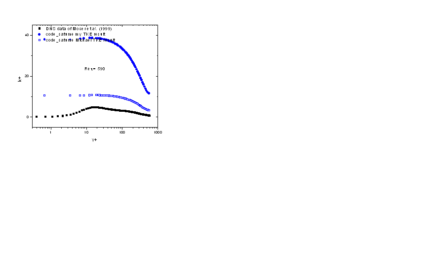

yes Mickaël i have use your xml file which i have send you Friday 01:54.
you can find as attached his listing file and my comparison with DNS.
thanks
- (5.82 KiB) Not downloaded yet
Mickael Hassanaly
Re: 2D turbulent channel flow: pb with TKE results
You use a Rc version of Code_Saturne which is not the final one. Could you download the latest version 2.0.1 and try again?

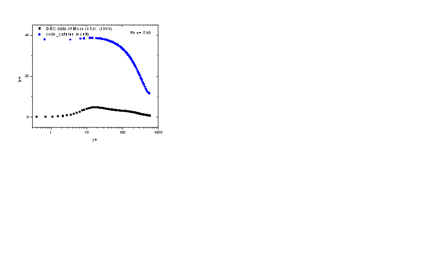

gina
here the comparison with your tke.dat file.
- (6.83 KiB) Not downloaded yet
Mickael Hassanaly
you assume a u_tau=1.00005m/s but in the listing file u_tau which i suppose to be uk for Code_Saturne is about 1.77m/s in my case and in your listing, it's 3.37m/s. Could you confirm that u_tau is turbulent friction velocity in your case?
