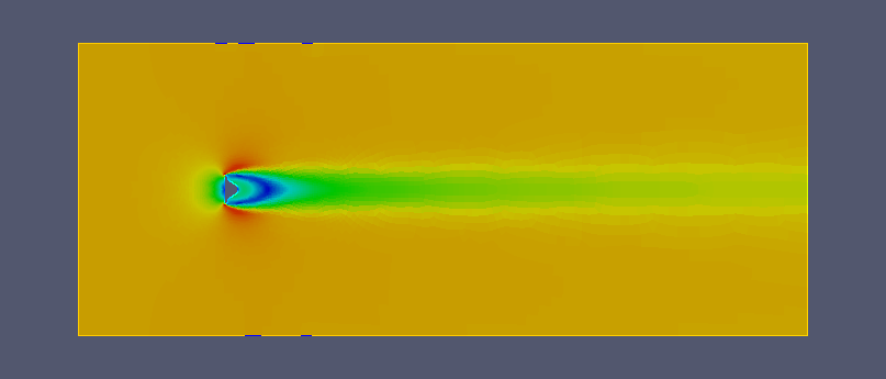

never the less for checking purpose i replaced wall with outlet and the pressure i was getting was correct but for wall its so absurd. i am attaching a pressure coutour symetry plane then you would get idea for what kind of body i am trying to calculate Cd.
