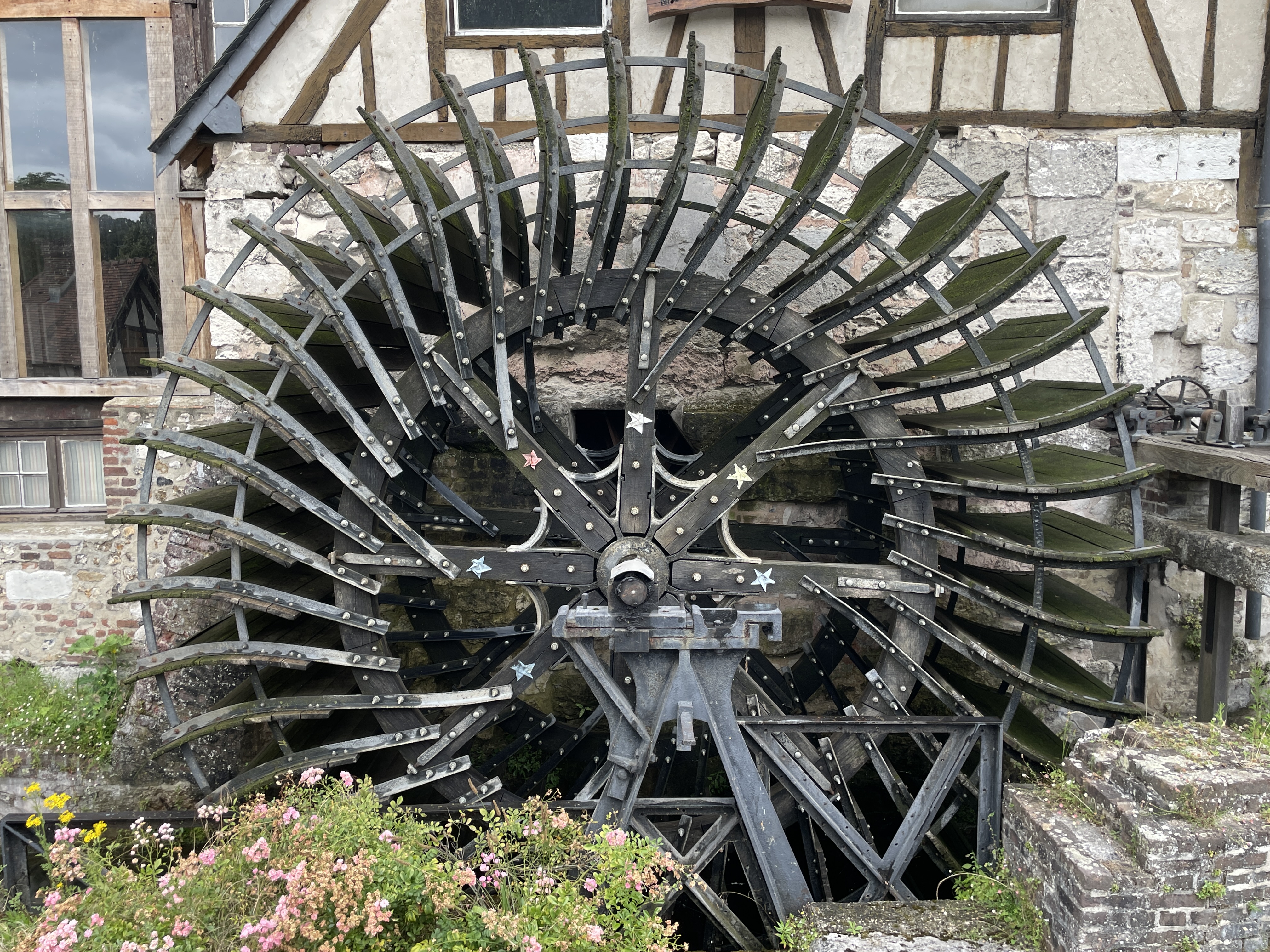

Thank you for your response, and my apologies for the confusion regarding the topics. I am seeking to optimize partially immersed water wheels across various configurations. These wheels are typically employed in mills, as shown below:
Water wheel (Pannvert mill, Rouen)
Could you recommend or assist in identifying/getting the most suitable tools for this purpose?
