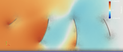

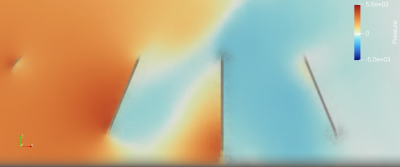

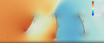

Assuming that "Neptune_CFD", that I don't have, is mandantory for a bi-phasic experimentation, I tested "only" immerse parts of the wheel with the followings conditions:
Test Conditions
Flow Velocity: 2.0 m/s, static wheels.
Blade Configuration: 16 blades, 20 cm maximum submergence
Analysis Focus: Pressure distribution (ΔP) as an indicator of applied force on the blades
1. Straight Blades in Free Flow ("Au Fil de l'Eau")
Configuration: Straight blades, open water
Observation: Minimal thrust (low ΔP).
2. Circular Profile Blades (R:30 cm) in Narrow Channel.
Configuration: Blades with circular cross-section, confined channel
Observation: Higher ΔP compared to free flow.
Analysis: Channeling increases flow velocity and pressure differential
3. Straight Blades in Narrow Channel
Configuration: Straight blades, confined channel.
Observation: Moderate ΔP, improved over free flow.
Analysis: Channel walls accelerate flow, increasing pressure on blades; still drag-limited but more efficient than free flow.
Any idea to improve it? How can I get Neptune_CFD please?
16 blades, straight,, narrow channel
16 blades, circular profil (R: 30 cm), narrow channel
16 blades, circular profil (R: 30 cm), narrow channel, turned by 38 degrees

And the last picture with 16x straight blades, open waters
Posts: 4293
Re: Water wheels
This topic should be in "general usage", as it contains questions relative to code usage, and not discussions on development, roadmap, .... exxcept for the question about neptune_cfd.
AS for the question, neptune_cfd is provided to some industrial or academic partners, and this is subject to approval by all neptune_cfd owners (EDF, CEA, Framatome, ASNR), so this usually involves some form of partnership between your organization and EDF. So no guarantees here, but you can send me a private message that I can relay to the proper contacts (who are colleagues in the same group), or you can send an e-mail directly to neptune-support at edf.fr. But this is only a first step...
Is you flow multiphase ? If the wheels are completely immersed in water, code_saturne should do fine. Otherwise, code_saturne's VoF features might be combined with the turbomachinery module if part of the wheel is outside the water. Since the VoF feature is work in progress, I would recommend the latest (v9.1) or development version in this case, but I can check with colleagues more familiar with VoF.
