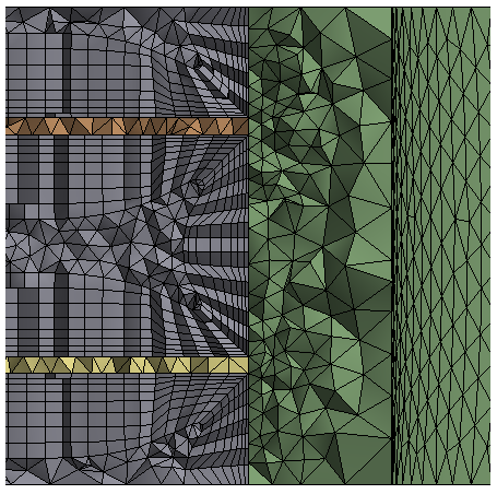

Regarding mesh inflation layers and joining. I attached the picture with mesh cross-section for the finned tube. There are tube wall, fins and air volume with inflation layer (marked with different colours). As I understand, Saturne can turn internal named slection into internal wall (boundary insertion in mesh preprocessing) but not to build inflation layers. Is there a function I'm not aware of? I cannot find layer parameters like first layer thickness and number of layers in Boundary insertion in Saturne GUI.
How joining errors look like. Ihave not ready joining filed (din't keep non-conformal variants) but, if you look at the joining.case in Paraview, you will see that most of inflation (air) and tetra (fin metal) faces are joined, while there are some "holes". Joiner cannot understand "flat" pyramids of the first inflation layer contacting with tube fin metal tetras. Maybe it's algorithm limit that cannot be fixed. The mesh itself is good, CFX runs on it.

Yes, code_saturne can build inflation layers, though the handling of "sliding" conditions for faces near to but not adjacent to extrusion layers needs to be improved.
This is not available yet in the GUI (for this reason), but has been available through user-defined functions for a while.
Search for "Boundary Layer Insertion" in this page : https://www.code-saturne.org/documentat ... _mesh.html
Using this, you can see a few usage examples :
https://github.com/code-saturne/code_saturne/issues/33
https://github.com/code-saturne/code_saturne/issues/7
This could be improved completed, though we have quite a few tasks with higher priority...

About your issue with intersecting layers. It's indeed one of known problems. There are two options: layers compression and layers stairstepping (gradual reducing number of layers near collision zone). As I can see, you used stairstepping, but compression is more universal. Stairstepping may be used if only solver supports arbitrary adjacent cell size ratio because, in practice, you will have a "thick" tetra connected to a very thin prism in area with reduced number of layers. CFX can do it, but, I think, it's too complex for Saturne (older versions can't cope with such growth ratio and diverge inspite of relaxation, similar thing is for Fluent: no fully coupled velicity|pressure - no support for very bad mesh). Anyway, this mesh will not be of good quality (yes, we use such with CFX if there is no other way, but it's a "dirty method").
Again, inflation is a hard task for arbitrary geometry. It's normal that basic mesher will not be able to layer arbitrary geometry. Important thing is to correctly point what exactly was a culprit to allow user to fix or simplify geometry in problematic zone.

Thanks for your info. Joining and outlet extrusion are indeed the cases for in-solver mesh modifications. Parallel layer insertion is very useful because it's very time-consuming in serial mode. Regarding layers compression, I always use this option in Ansys Meshing - no problems. Main culprit with layers if they are built successfully themselves is the growth ratio:
1. When only a part of wall surface may be inflated due to layers algo bugs/disadvantages (Mesher just cannot build layers and does not point to particular problem).
2. When outer layer cell height is much smaller than bulk volume cells (usually, tetras) because you cannot build better layers for specific geometry (number of layers must be reduced).
In first case the mesh can only be used with CFX with it's coupled velocity/pressure solver (although it's not good to use such mesh, sometimes, there is no other way while no artifacts/problems either). Other codes cannot work with such mesh (I think, SIMPLE-like things has zero chance, I tried with Saturne - it diverges, Fluent doesn't work also).
In second case, it depends on particular growth rate. If it's not very big, Saturne works. So, getting back to layers algo, it should produce reasonable growth rate at main/inflation mesh interface. That's why I would try to add layers compression option in addition to stairstepping.

Regarding layer compression, not that code_saturne's algorithm, as called in user-defined functions, works in 2 steps. The first step returns a structure containing an array of vectors, one for each extruded node, and a series of curvilinear coordinates for positioning of each layer. in theory, this allows an advanced user to have very fine control of the layer positioning, though I do not know of anyone really bothering to modify this, as using the defaults is more practical.
I need to add a visualization option for each extrusion step, so as to allow the user to understand how the algorithm is working, and making it easier to fine-tune it for complex geometries.
