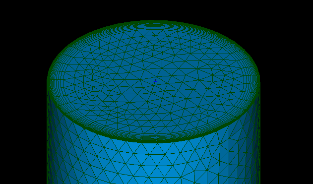

I am trying to learn code_saturne usage and I encounter an issue I cannot fix. Basically, I am trying to perform a simulation on a simple 3D pipe with water flow specified at the inlet with a reasonable velocity value to generate a turbulent flow. The idea is just to perform simulation starting from scratch, generate the mesh with salome, run the simulation with code_saturne and post-processing with paraview. I obtain a mesh which is not too bad from Salome (from my pov) see a picture just after :
The transition between the last layer of prisms and the middle cells is a bit high but from my point of view it should not be an issue for a such simple case. I mean, the solver should be able to handle this mesh...

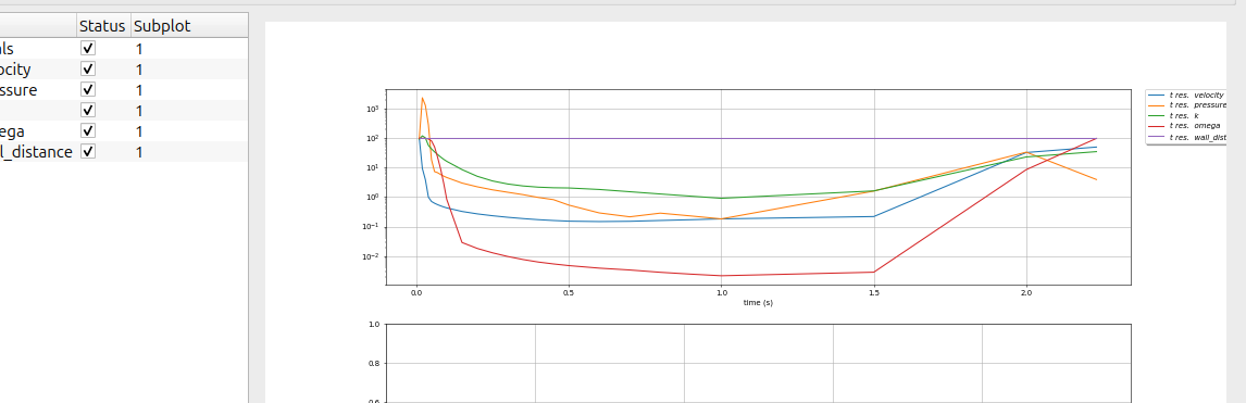

I run the calculation and at the beginning everything is fine and after a while, the residuals starts to become crazy :

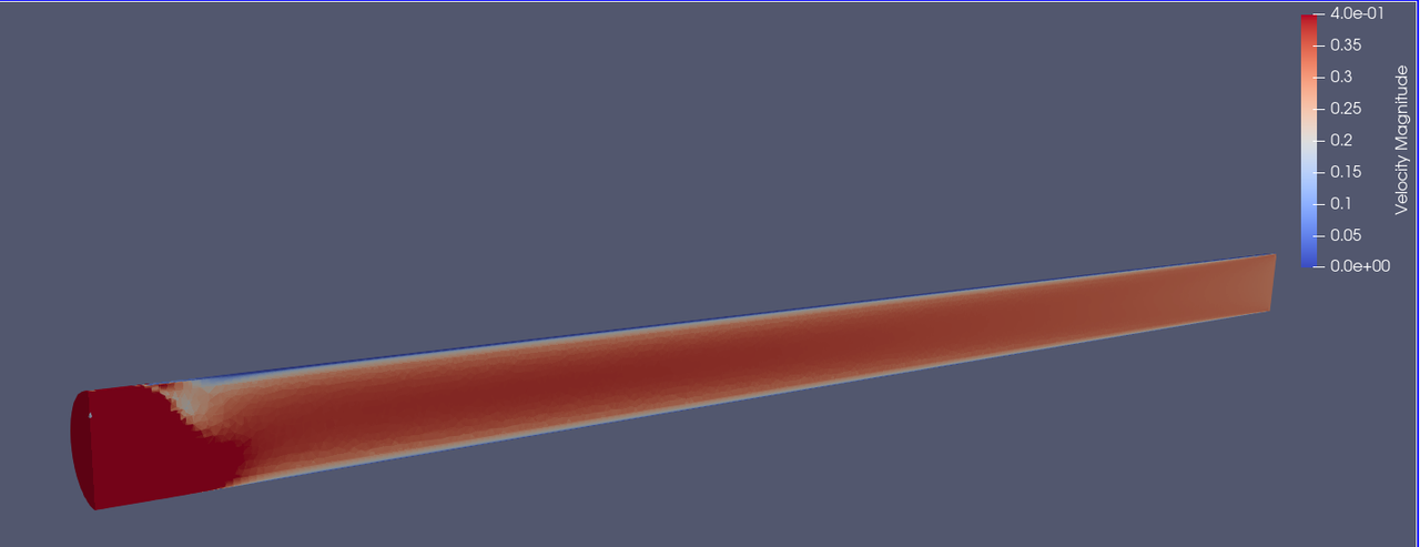

It seems that the pressure starts to be crazy and finally the simulation diverge... I have checked the calculation in Paraview and it seems that the issue is linked with the outlet even though the velocity profile is reasonable everywhere before starting to become crazy at the outlet. See just after the outlet when it diverges :
I have tried to keep the settings as default as possible to perform this "basic" simulation. I have tried to change the mesh, increase the length of the pipe, increase the water viscosity by a factor 2 and the same issue still to occurs. The inlet velocity is at 0.3 m/s, k-w SST turbulence model is used and I am using SIMPLEC with a constant time step option and 0.01 sec as reference time step. Of course, I thought about an issue about the outlet boundary condition but there is apparently nothing to specify regarding the oulet in code_saturne GUI...

Outlet boundary conditions tend to have a high sensitivity to mesh quality in code_saturne, so whether using tetrahedral meshes or even hexahadral meshes with cell warping at the outlet, the following options usually work well :
- Add one or two prism layers at the outlet using the code's mesh extrusion features (in the GUI, under Mesh/Preprocessing)
- If this is relevant, use an imposed pressure outlet instead of a standard outlet.
If the outlet profile is known, imposing a "reverse inlet" at an outlet (and a free inlet/outlet for an inlet) can also help, when all else fails.
In your case, mesh extrusion at the outlet should do.
We do need to work on outlet boundary conditions to mitigate this issue in a more automatic manner....

You are right, I have added 3 prisms layers on the outlet and the simulation converged ! Just for my curiosity, how could I impose a pressure outlet instead of a standard outlet ? Indeed, it seems not possible to impose anything on the outlet with the GUI...

If you wish to explicitely set the pressure, you need to choose "Imposed P outlet" as a boundary type in the GUI instead of "Outlet" (the latter computes an automatic value based on the reference pressure and hydraulic head).
