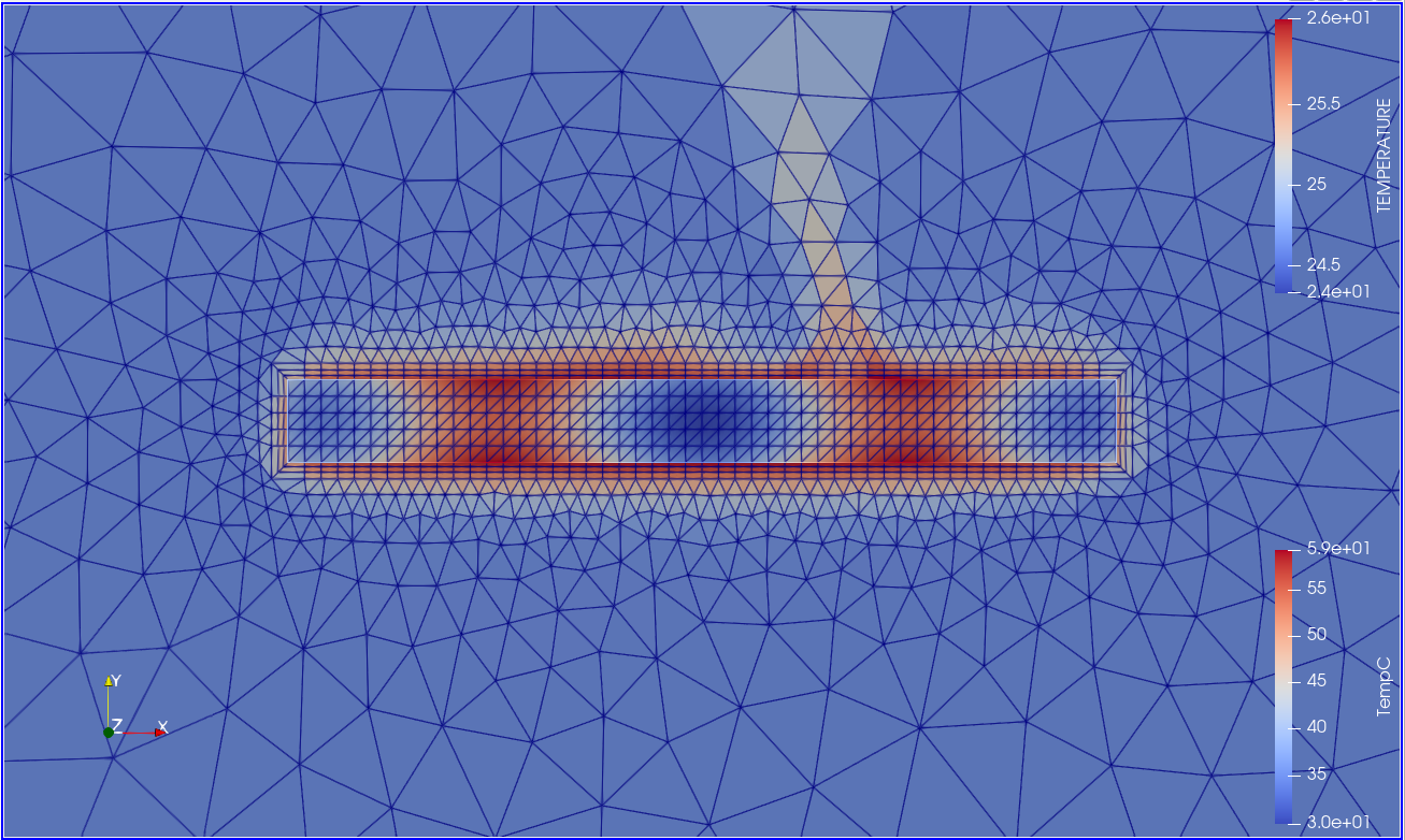

I am quite confused by the coupled Syrthes/Saturne result I get. I have a heating solid bar centered within a fluid domain. The solid bar is heated by Joule effect which I temporarily model by a handmade heating field.
What I am interested in is the thermal transfer between the solid bar and the surrounding air, and particularly the solid surface temperature.
Once I run the coupled simulation, I am very surprised to discover that my bar max. temperature is 26°C when the surrounding air is heated up to 59°C. Moreover, if I play with the power of the volumic heating field in the solid region, it affects the temperature of the bar, but does not change the evolution of the fluid (temperature, velocity, etc.).
Therefore, I suspect that my coupling is not complete and I am seeking some help to circumvent this difficulty.
Additionnaly, my syrthes mesh is 2D when the Saturne simulation is 3D. Could this be the reason?

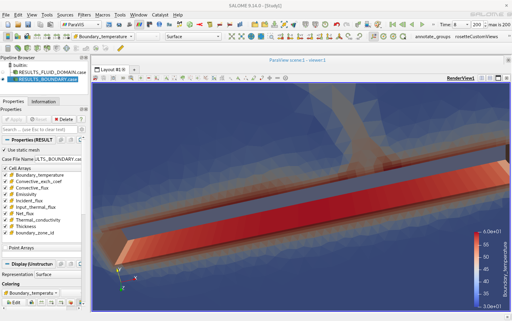

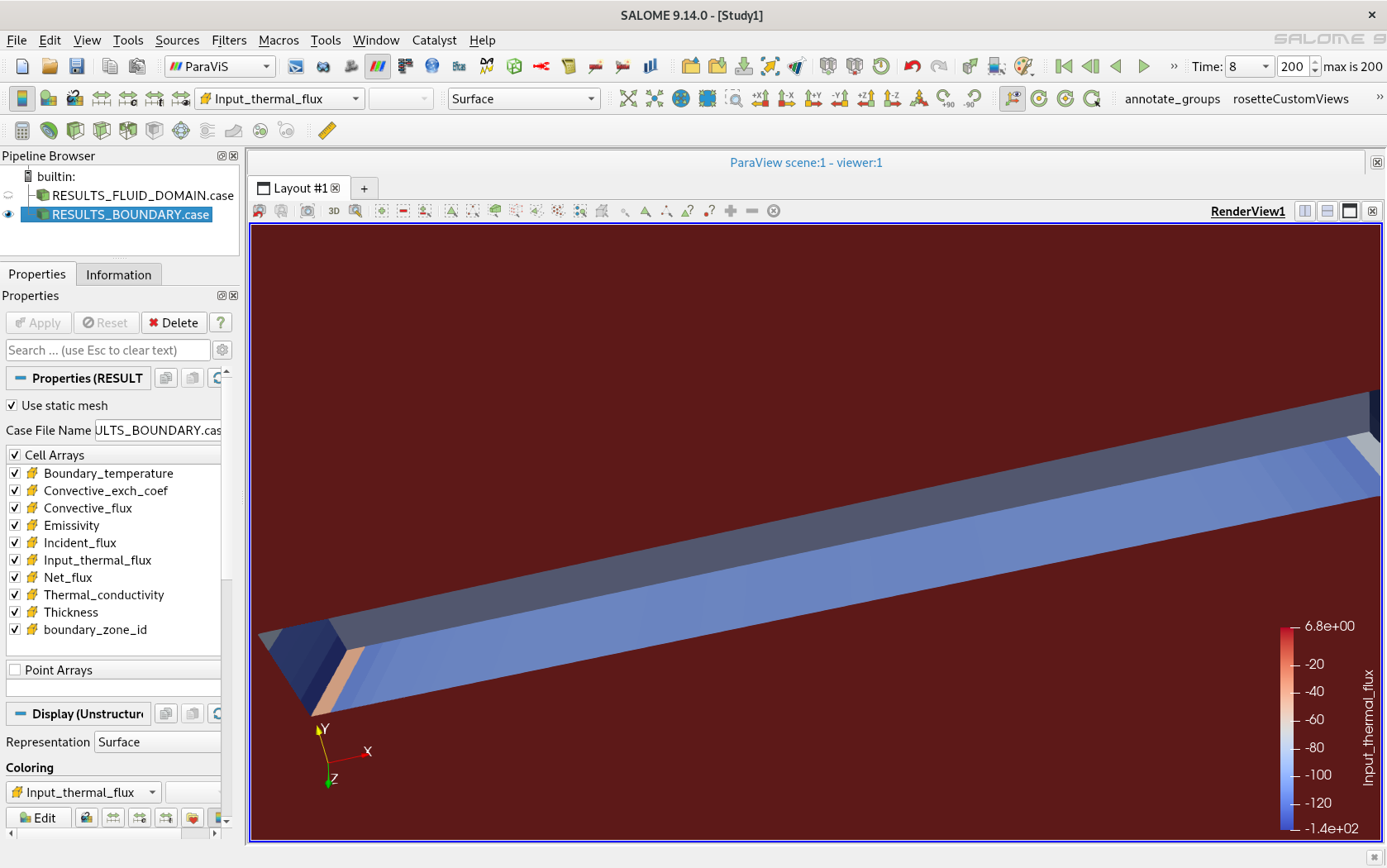

Here are the thermal Flux and Boundary_temperature at boundaries.
1. Why are these quantities given on the volumic mesh and not only at the boundary faces?
2. The input thermal flux is globally negative. Does it mean the heat is going from the fluid to the solid?
3. The heat exchange is not underestimated, since the solid is way colder than the fluid. I don't understand how a 26°C metal bar can heat air to 60°C.

1) The quantities should only be on boundary faces. Do you have separate writers for volume and boundary faces ? If not, using "extract block" under ParaView might help separate them.
2) Yes, this sign is chosen from a "finite volume" rather than user perspective. A negative flux means heat flows from the fluid to the solid.
3) What are you initial and other boundary conditions for the fluid ?
