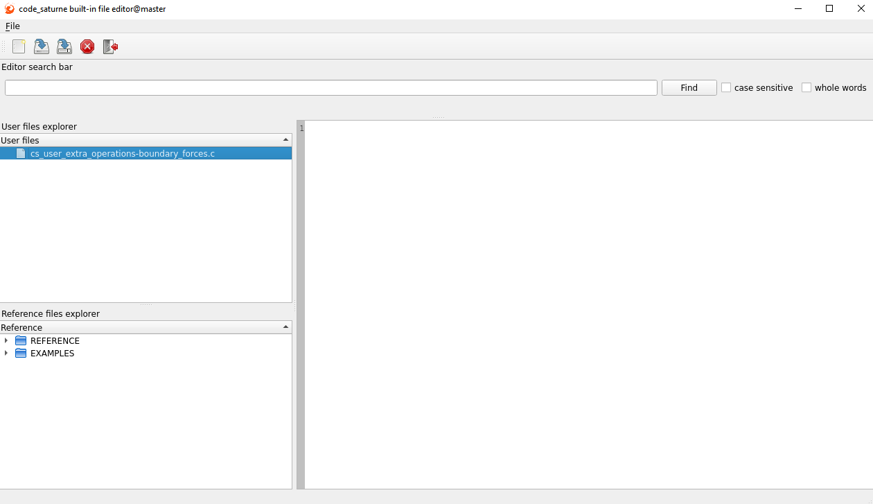

Thank you for your reply, I am not sure how to generate the boundary forces using the gui do I select the user-function ?(see screenshot attached).

Posts: 4301
Re: user-defined functions
Simply select the boundary forces output in the Postprocessing/Surface Solution control section.
