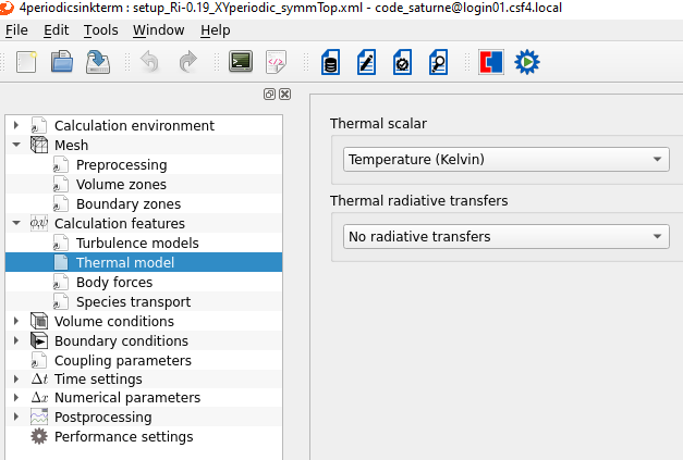

The total enthalpy is 1.529331e+02 (> 0), approximately 0.525*292K (the total volume*the reference air temperature). It seems to be reasonable but it doesn't change. It just keep the same value with time step increasing, and equal to the previous time step total enthalpy.
For the final point, I think I solve for the temperature since I choose Thermal model-Thermal scalar-Temperature(Kelvin) as shown in the picture and setup.xml. And What you mean "If you are solving for temperature, you may want to rename references to enthalpy." I think in my code, I use temperature* volume to get the enthalpy, and then use feedback_term=delta_enthalpy/total_volume to get the feedback_term. So the feedback_term is acctually for temperature. It should be right I think. Is this what you mean? Thanks!
Ximeng

Yes, you seem to be using the standard temperature resolution.
Do not forget that for enthalpy, you also need to multiply by density and CP. If this is missing your sink term might simply be too small ?
What are the other factors (boundary and initial conditions) influencing enthalpy here ?
