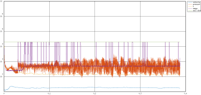

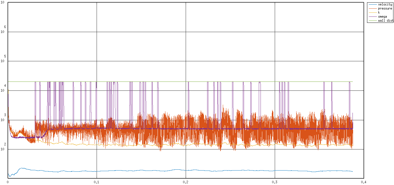

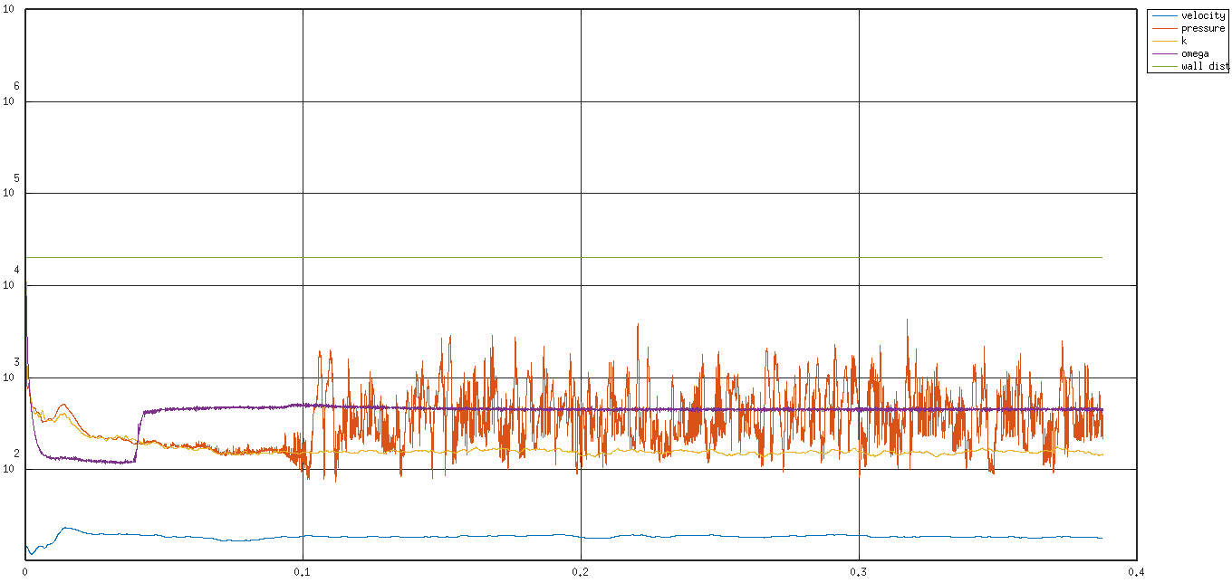

I am keen on correctly setting this variable as I observe that it significantly influences the evolution of residuals. I have attached two cases in which I changed the value of the xyzp0 variable in cs_user_parameters.c (although, while monitoring the run, I still do not observe a null relative pressure where I set it). First, I would like to know how to set it to effectively register a null relative pressure at that location. I am running a case of external flow around a vehicle similar to the Ahmed body.
I understand that a certain oscillation in pressure residuals is to be expected, given that I am simulating turbulent flow with the DDES model. However, I believe that the oscillation in the pressure residuals in the attached images might not be accurate.
EDIT: Additionally, I noticed, when I save the pressure field at various time steps, that the absolute values seem to oscillate continuously, although the pressure differences are maintained. Obviously, there is a problem with the reference pressure setting.
Posts: 4283
Re: Setting reference pressure position (xyzp0)
Pressure residuals tend to oscillate much more than those of other variables, and this is not surprising, given that the pressure is not a "true" physical variable, but more of a numerical variable solving for the incompressibility constraint.
I checked with a colleague, who recommended not changing the settings for the reference pressure position, though I agree it is a numerically sensitive point. That does not answer the question about the changing reference. I'll try to get an answer to that, but don't have it yet.
