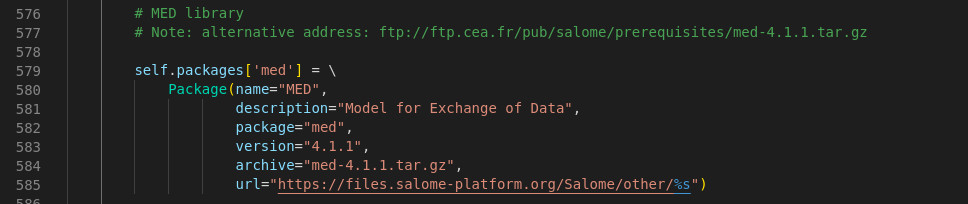

You can see the fix in the install_saturne.py at line 577. Use the FTP location instead by modifying line 585. It will work.
before:
after:
