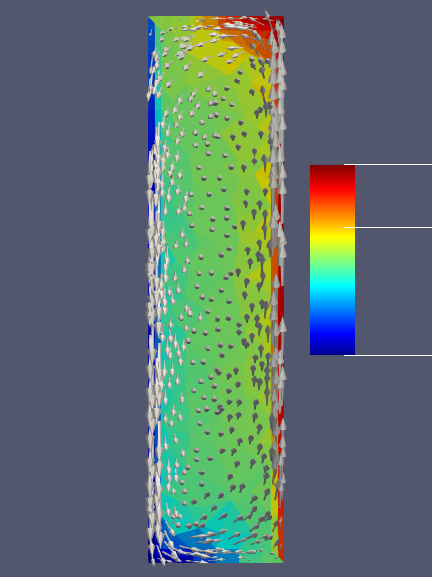

which looks right. I also ran a testcase with dry air as medium. A rectangular duct with axial flow and one side cold and the other side warm, and it seems that temperature functions works as well when setting "Material Law" for the density function.
