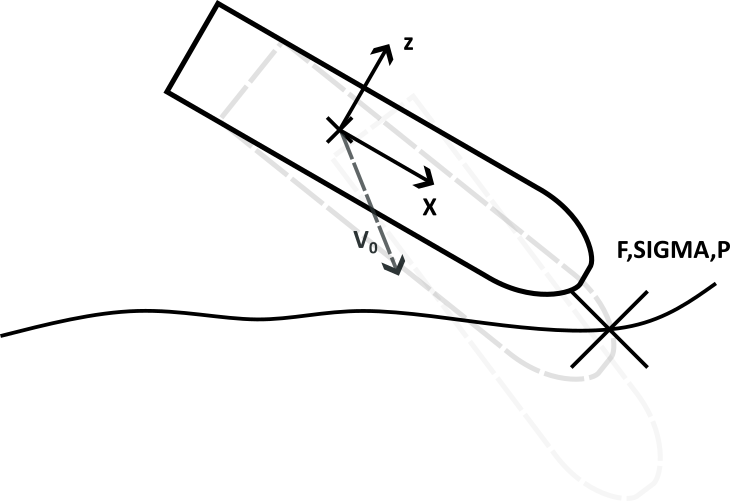

Hi, I appreciate the time you take. My Reynolds is in the between 10^4 and 10^5 ( depends on the result of my previous model which I'm finishing up as I speak ).
The cylinder would have a round nose, would be completely rigid, and I would imagine the cylinder could have a rotation on the Y-axis (see graphic).
I would like to compute a pressure/constraints or a force at the water entry point, in order to calculate the constraints on the nose.
This model will of course be coupled with an experiment to deduce a vague constraint applied to the nose in real life conditions.
I am of course not avoiding computing a simpler modal in Octave or else, although I'm not familiar with fluid-structure interaction theory, and would have hoped to be able to setup a model in Code_Saturne to familiarize myself with the notion while not losing too much time on setting up my own model. That is still of course an option.

Re: OBJECT IMPACT ON WATER
Ah, so then this is motion in 2D, but a 3D flow (so not really a 2D problem)?
If you would accept a fixed velocity of motion, to get the force / impulse, I have some experience with this from the VOF side, and from what you are saying may be enough for this initial phase of impact. Overall, it may be a little time-consuming depending on your computational resources, but it is possible.
I agree with Yvan that if with VOF, a fixed object (i.e., a reference frame fixed on the body, with the flow moving past) would be simplest to implement, etc. (Depending on how long of an simulation you want, I don't know if the effect of gravity will even be important? - that could simplify the setup further if that can be neglected.)
