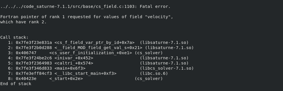

I am using code_saturne V7. When I used cs_user_initialization-compressbile.f90, I had an error as shown in the figure.
Same error occurs when I used cs_user_initialization-gas_ebu.f90 for the combustion case.
Does anyone also have the same problems when using cs_user_initialization.f90?

It seems there were errors of dimension when accessing the velocity array.
under fortran if you get the pointer of velocity vel, then the initialisation for the cell iel is
vel(1, iel) = u0
vel(2, iel) = v0
vel(3, iel) = w0.
Notice now the compressible module is not compatible with combustion module, the behaviour is not tested. I posted under your previous question how to consider the density variation. If your scenario is low mach where the acoustic wave is negligible, you don't need to use compressible algorithm.
