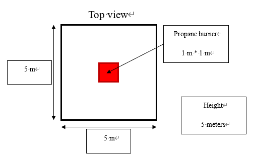

The picture N1 describes the geometry of my model.

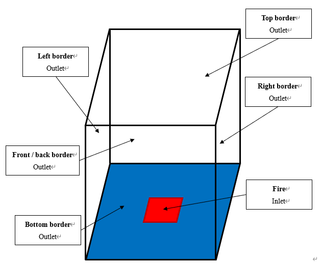

The picture N2 summarizes the boundaries of my model.

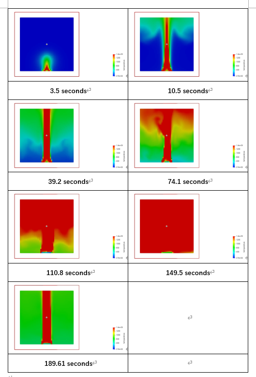

The picture N3 describes the evolution of the temperature on a slice in the middle of the model.
As you can see, the very beginning looks quite "normal". We can see the fire plume being created and the hot temperature remains close to the plume which is what we can expect in reality (convection neglectable in front of radiation at medium / far field).
But, very soon we see something like a reflux of hot gases within the domain which leads to an elevation of the temperature within the whole domain during a certain amount of time before things starts to cool down again.
In the end (after temperatures cool down), the plume also seems to me a bit "taller" - At least, I am not used to meet such kind of temperature that high under the fire source whatever it is using FDS or reading scientific papers on similar experiments - So my opinion is that there is an issue in my inputs because theses results are for me unphysical.

I also tried replacing the lateral boundaries(left, right, front and back borders) by boundaries of type Free inlet / outlet but it seems it just heavily slows down the whole calculation (for now the calculation is not over (as it is very slow) so I cannot say precisely that it won't change the results in the end ---> This conclusion should be taken with caution)

Here, the N4 picture as I don't succeed to insert it into the previous text message...

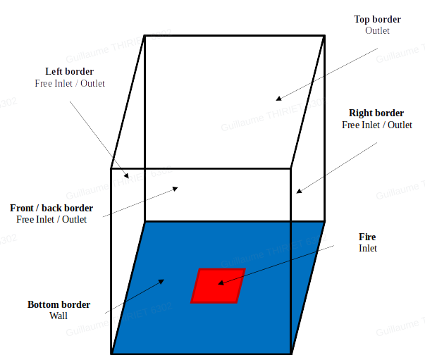

BOUNDARY CONDITIONS
In order to correct the issue met in my last message, I modified some of the boundary conditions from OUTLET to INLET/OUTLET.
The following picture describes the new boundary conditions applied on my model. RESULTS

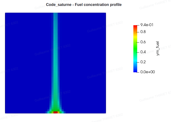

The picture below presents the temperature profile resulting from the code_saturne calculation. The picture below presents the fuel concentration profile resulting from the code_saturne calculation. According my experience modelling fires, the results of code_saturne does not seem physical.
The flame height is far higher than the one calculated by FDS (code_saturne --> > 5 m / FDS --> max 3.5 m).
The temperature profile is far higher than the one calculated by FDS (code_saturne --> max 2500 C / FDS --> max 1500 C).
Both these values are not physical but I do not have solution to solve this issue.
