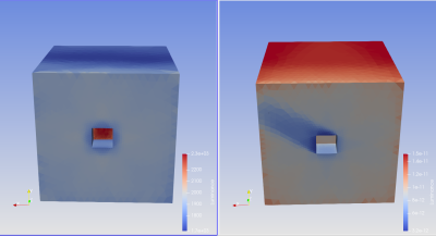

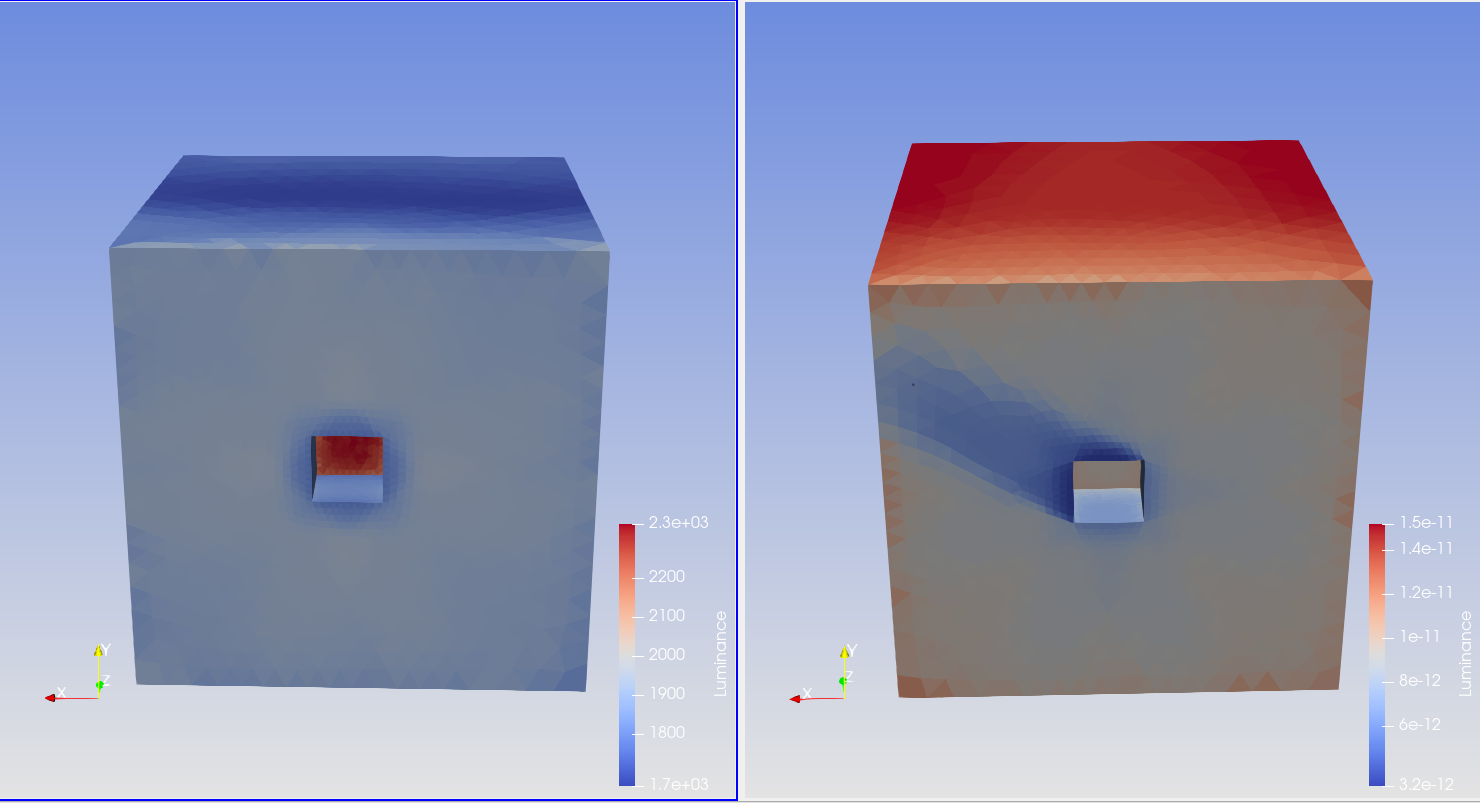

I add a screenshot of the two compared cases (on the left, the 1D model is activated, the luminance has the right magnitude, on the right, the solar charge is activated without the 1D model, with a bad magnitude but a good solar direction). If anyone understands how to set parameters in order to have both benefits? I tried to understand atr1vf.f90, and it seems that enable 1D radiation means to have a vertical solar radiation.
