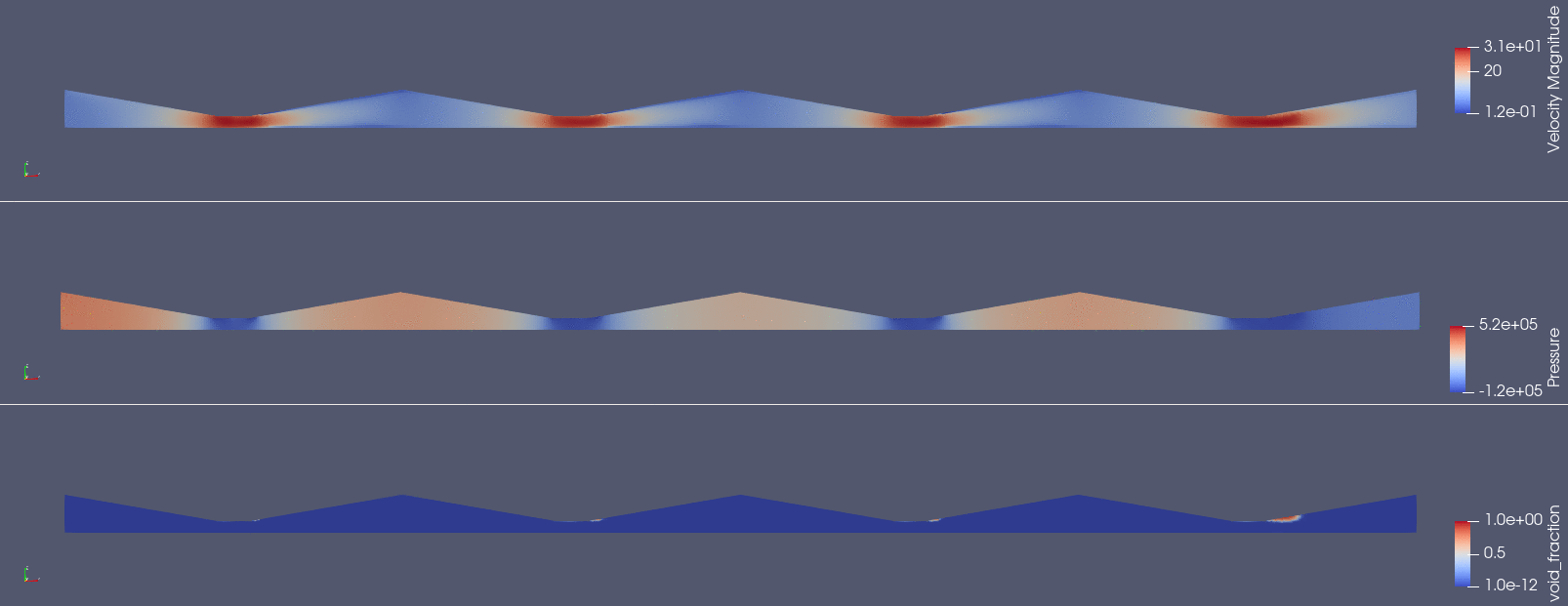

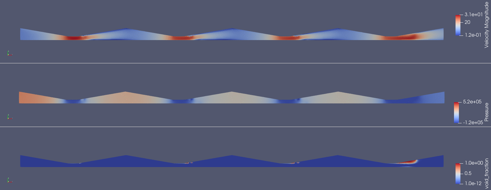

I checked and ran your case with CS 7.0.4. The time step discretization in your setup was set to steady, but in this situation the regime is transient. The simulation now runs with a time step of 1e-4 s (Co max ~ 2.5) after the change. It is accurate to say that the maximum fluid velocity is around 27 m/s, which results in a negative (total) pressure in the venturi region.
In the lower pressure areas, void fraction is produced when the Vof + cavitation model is active.

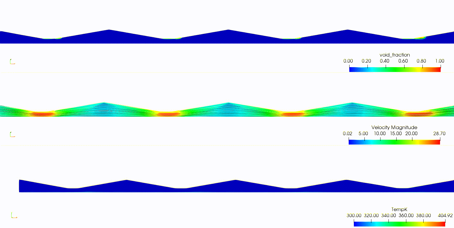

See for example the following different velocity profile with different CO

lorenzo.iron wrote: Thu Sep 29, 2022 1:11 am 1) if I run the simulation with the Time Step Option = "Constant" (and reference time step = 0.0002 as suggested) the simulation stacks because of an excess of fluid speed. Did you face the same issue?
No, but in your setup all the numerical scheme where in automatic, you can try to set to an upwind scheme.
lorenzo.iron wrote: Thu Sep 29, 2022 1:11 am 2) if I run with the Time Varying (Adaptive) Option the simulation basically runs but the result is dependent on the choice of the parameter Maximal CFL Number. What CFL parameter did you set in your simulation?
As I say.. for a dt = 1e-4 I get a CFL max ~ 2.5, you can read the BPG for more detail about time stepping. https://www.code-saturne.org/cms/sites/ ... meters.pdf
