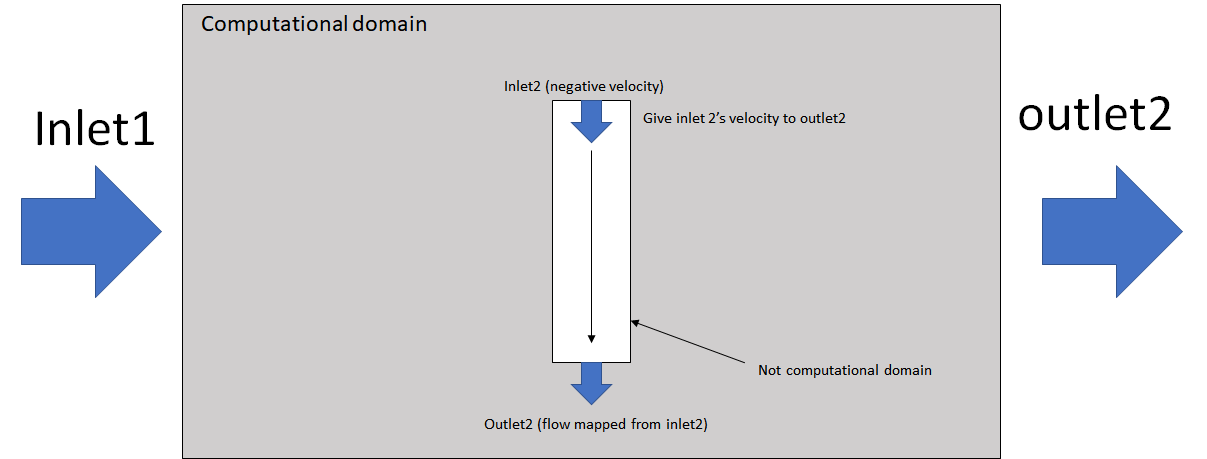

I have a question about the mapped inlet.
I have never used the mapped inlet, I know some people used it to make a pseudo-periodic boundary condition.
You can see a picture I want to calculate. (Geometry is simplified very much now to show you clearly.)
As you can see, there is a space (white space) inside the computational domain (gray space).
Although it is a little bit strange, I have to impose an inlet condition with negative velocity (to simulate a suction).
What I want to do is to extract variables at inlet2 and then impose these variables at outlet2.
(Actually in my case. the "inlet" condition in GUI is also imposed on outlet2.)
By the option "mapped inlet"m is it possible to do this?
Sorry it might not be clear for you. Let me know if you need more explanation.

This might work, but in its current form, mapped inlet takes values at cells and maps them to inlet/outlet faces, so instead of mapping exactly to inlet 2, you would need to map to the cells adjacent to inlet 2 (true face -> face mapping is requested by some users, but has not been adapted yet).

In the picture above, at the inlet3 surface, I give negative velocity (like a suction). Then I want this value to be extracted and reused at surface4. So now at the surface4, I hope the flow velocity should be 0.5m/s moving from left to right direction.
For this, in GUI, I have to select the option "mapped inlet" in "inlet3" boundary condition setting? or I have to select "mapped inlet" in surface4 boundary setting?
I am confused with "the translation vector".
Now the distance between inlet3 and surface4 is 0.2m, so I have to give 0.2 translation vector in the setting for surface4?
For example, in surface4 boundary setting, when I give -0.2 for X, from which cells does surface4 get flow condition?

You need to define "mapped inlet" for surface 4, and choose an associate translation vector going from surface 4 to the cell layer just upstream of surface 3. Do not hesitate to experiment with the code in case of doubt.
