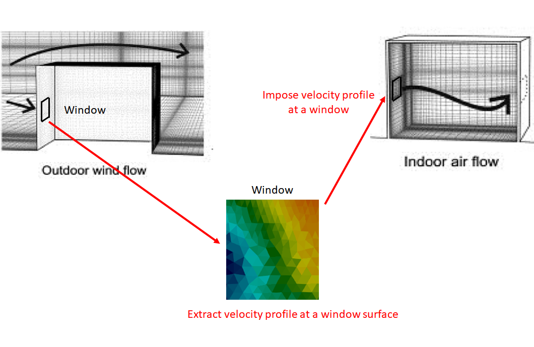

I am doing simulations for outdoor and indoor separately.
Then what I want to do now is
1. outdoor flow simulation and extract a velocity profile (surface profile (2D), not 1D profile,) at a certain plane near a window which I select
2. impose that surface velocity profile as an inlet condition at a window of a building for indoor flow simulation
You can see clearly this in a picture
Is there some way to do this in code_saturne?

You can check the following example : https://www.code-saturne.org/documentat ... er_2d.html
To adapt it to your case, you would need to install code_saturne with MEDCoupling support (see downloads on https://www.salome-platform.org/).
