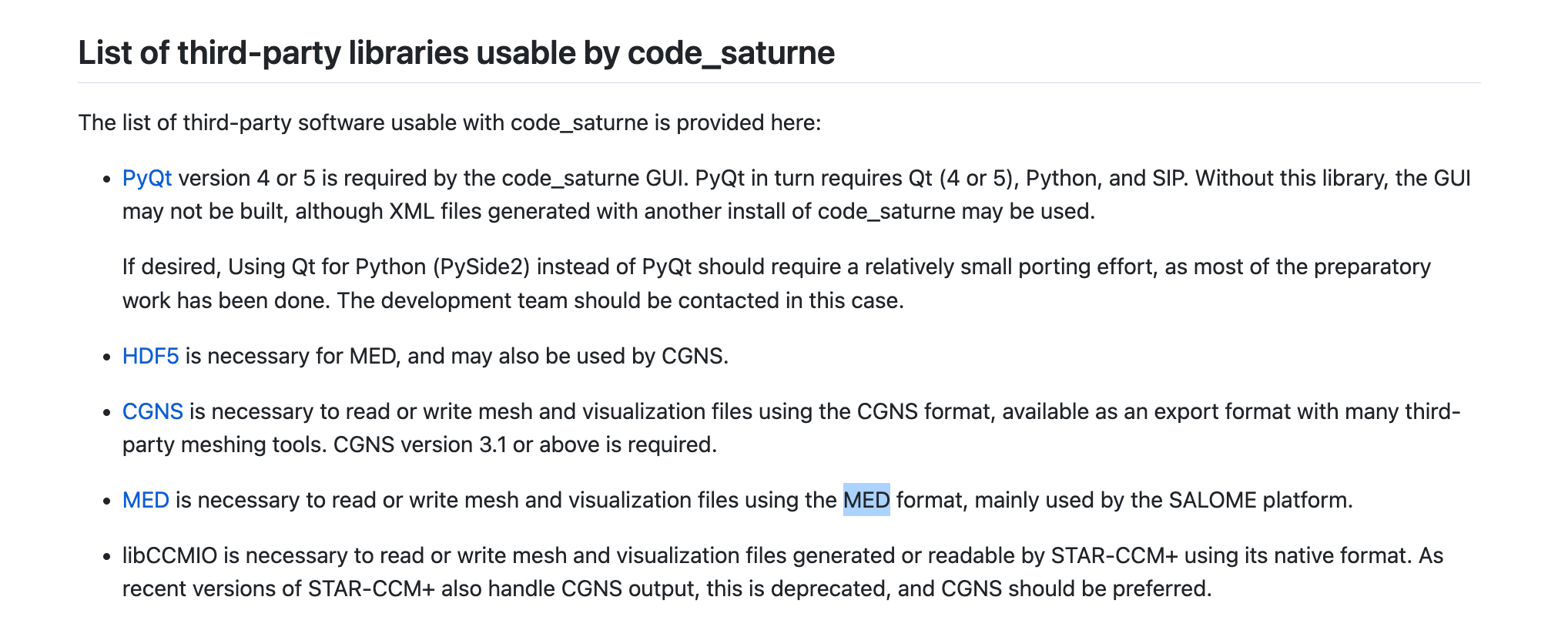

In the code saturne installation README instructions, the link for MED does not work.
https://www.salome-platform.org/user-section/about/med
I would like to enable MED support on my code_saturne installation (v 7.1.1) and compile it with ("--with-med" option) but I am not able to find the source code online . I noticed the saturne tutorials repo contain many examples with MED files so it tells me I'm better off supporting MED files .https://github.com/code-saturne/saturne-tutorials
Can you link me where I can compile with MED? Can I get MED independently of SALOME? or do you have to have SALOME in order to have MED? I prefer to compile MED stand-alone. If a majority of the tutorial examples are MED files, it tells me a majority of code_saturne's use cases are with MED files so I'd like to get help on how to support it.
