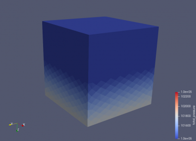

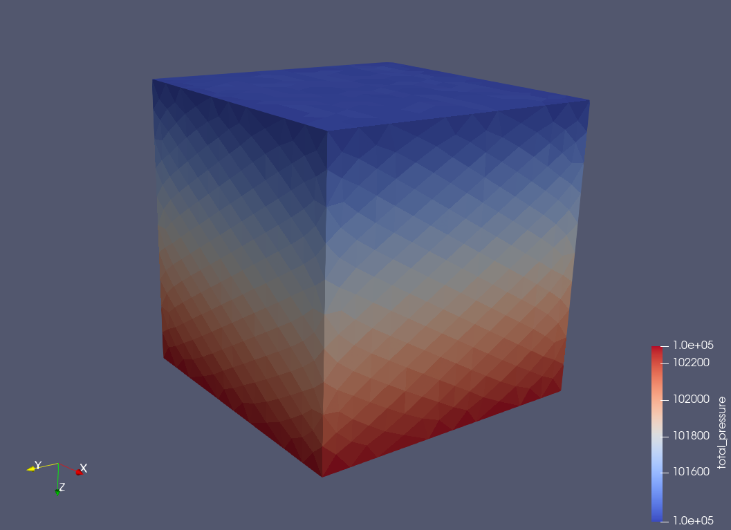

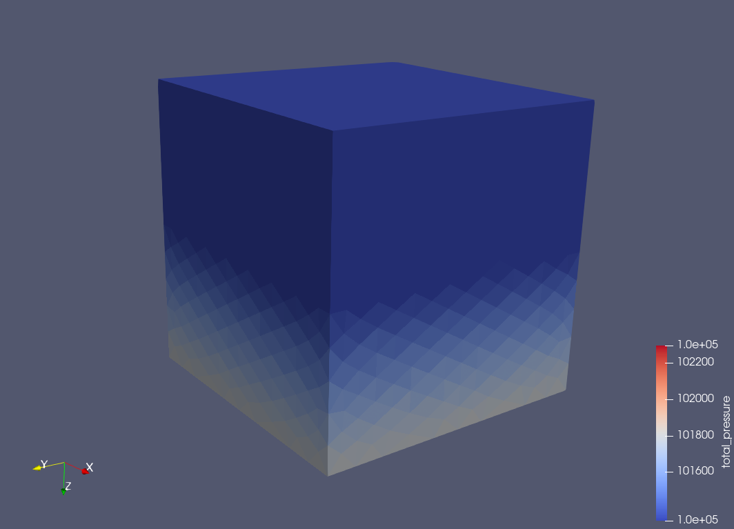

I found the my model results (under the z direct universal body force) has a bit of discrepancy compared with the benchmark which the body force was set through GUI. Here is my final source term code:
It reads the x, y and z components of acceleration from fields. In this case, x and y are 0, and z is 9.8 m/s^2. Then calculate the force_x = volume * acc_x * density, force_y = volume * acc_y * density, force_z = volume * acc_z * density.
I have attached the screen cuts of the total pressure. You may see the one subject to the GUI defined body force is higher than the one produced by my user code. Not sure the root cause, I guess the body force was implemented in a very different way ???
REgards
ywan459
REgards
ywan459

When defining a source term with the GUI, using a mathematical expression,, that expression is converted into C code in one of the cs_meg_*.c files you can find ind the "src" subfolder of computation run directories, then compiled along with user-defined routines.
It may be interesting to compare the expressions in those files to the one you programmed.
