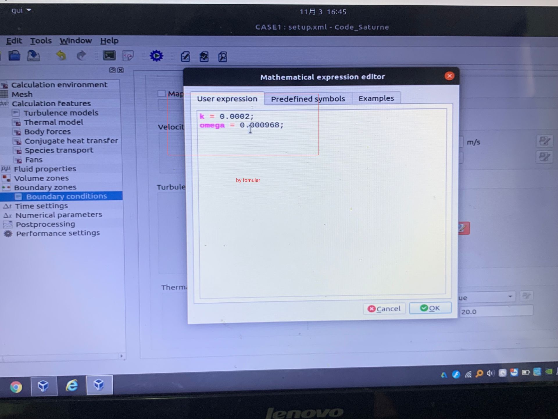

when I set the boundary conditions, I find that I can choose two types, one is the turbulent calculation by formula (k and w), another is a calculation by hydraulic diameter.
I think the tank is enough long and wide, so I can think this tank is a Wide shallow open channel,because the water depth is small in comparison to wide and long. so I would like to set the water depth as hydraulic diameter.
But I also have the value of the k and w.
so it means that I have two choices.
I don't know my understanding is correct (attached the screenshot)

You can either impose directly the values of k and w at the inlet, if you know them, or estimate them based on correlations function of Dh , turbulence intensity, ...
If you don't know the k and w values, you are obliged to use a correlation.
Does this answer your question?
What does the inlet b.c. represent in your water tank?

In my understanding that I can choose the water depth or the k-w, only depending on which one I have. is it correct?
In my case, I want to simulate the one direction flow. so I think in my inlet, it has the flow come in.
I don't know if I understand your question?
