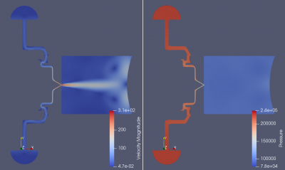

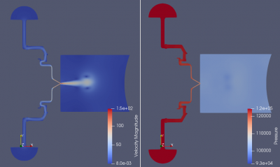

I also see a not very convincing difference in results between versions. A factor 2 on velocity and pressure.
After 3.5ms in v7(from github):
After 3.5ms in v5.04:
I tried to run a incompressible steady solution to have something to compare with but I the solution is unstable. If you have a standard test case (maybe also a bit smaller) I could try that, if you want.

I am sorry to seem knitpicking ... but I just installed v5.0.13 trough github, and as seen with Paraview the results from above case at t=1.0ms look very alike for all three tested v5 branches:
v5.0.4: Mach: 0.48 (max); Velocity: 160 m/s (max)
v5.0.13: Mach: 0.48 (max); Velocity: 160 m/s (max)
v5.0.git: Mach: 0.48 (max); Velocity: 160 m/s (max)
v7.1.git: Mach: 0.82 (max); Velocity: 400 m/s (max)
The inlet boundary condition is defined as volumic flow rate in all runs (same .xml). But yes indeed there is a bug in v5.0.4 as the application of the inlet condition as a mass flow failed to run - also for me.
