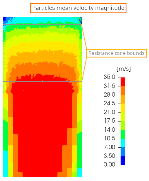

Hello. I guess I found the bug in Saturne 6.0.6. I'm not allowed to share the entire geometry, but, I think, it's not a matter of particular case. In this case, there is a gas duct with recirculation line intake and head loss volume zone that represent the tube bundle. Gas phase calculation was successful (tube bundle resistance is accounted for without problems), then I introduced particles on frozen gas velocity field. Although particles move by expected streamlines, when they enter volume zone with head losses, their velocity rises gradually by ~25m/s (gas velocity is around 7.5 m/s in this area). I attached picture with particles mean velocity field.
Case setup is very basic. Gas velocity in problematic area is ~7.5 m/s (aw well as particles velocity before resistance zone), gas pressure drop across resistance zone is ~250 Pa at height of 1.2 m (resistance coefficient is 16.8 m^-1). Gas density is 0.365 kg/m3, dynamic viscosity is 3.17e-05 Pa*s. There are 9 particle fractions (classes) with sizes from 2.5 to 100 mkm. I attach case setup [xml] files for gas-phase and particle runs (case for gas-phase run is marked with A suffix that means "pure aerodynamic"). Please note that, in particles case, some values for gas phase are not set.

Particle velocity profile

Thank you for the feedback. We are aware of this problem which is due to the fact, if I understand well, that the additional force you have on the mean fluid (with the head loss) is missing in the lagrangian module (all terms on the momentum are not automatically taken as they should).
We will try to fix that soon.

Hello, thanks for so fast reply. Sorry, but, I think, it cannot be due to a missing force on particles because, if you leave such particles with only drag and gravitational forces under case conditions (given densities and gas viscosity, constant gas velocity), they will not accelerate more than by 1.1...1.4 m/s (terminal velocities by 3 different models for largest particle class of 100 mkm). So I can only guess that you consider gas pressure gradient force on particles and there is a mistake like unit conversion in pressure gradient force. Although it may be something more deep. Hope you will fix it without problems.

What Martin means is that when using head losses in code_saturne, an external force is always added, but the Lagrangian module does not take it into account in a consistent manner, which explains the issue you have. This is more a refactorization issue in the code.
If you are trying to reach a steady state and have one-way coupling, a workaround would be to use head losses in an initial Eulerian computation, then run a "frozen field computation" , removing the head losses to avoid the extra term. For a coupled computation, a fix in the code is necessary.

As I am not an expert in that part of the code, I was perhaps not very clear, but the issue is one of numerics, not physics:
In the Eulerian part of the code, head losses are handled by adding an "equivalent" external pressure force. The Lagrangian model uses some elements from the Eulerian part, and terms should be handled in a consistent manner. It does not mean we would be adding a "physical" force, just making the model consistent. In any case, in a head loss region, I would assume competing effects, with acceleration with the flow due to reduced porosity/flow section, and slowdown due to collisions.
There has been recent work (in the master branch) so as to handle the "complete" turbulence model for Particles in a cleaner manner: so either particles are purely fluid (tracer), or handed as solid particles, whose handling with stochastic equations is adapted/synchronized with the Eulerian part. I cannot say more because I am not familiar with the details of the theory for the Lagrangian model in code_saturne (which is based on stochastic differential equations, not a collision model).
Again, the issue here is related to an inconsistent handling of some terms between the Eulerian and Lagrangian parts. So the forces which would need to be added are "numerical" in nature, to compensate for the artificial force induced by the pressure forces added to the Eulerian model. Otherwise, you get the acceleration you observe.
In any case, head loss zones are tricky, since the concept of head loss is simple in 1D but subtle in 3D, and mainly because the obstacles which lead to head loss often have effects on porosity (which handled by code_saturne), and turbulence (so specific turbulence source/sink terms should be added, but depend on the actual geometry, so a specific finer, resolved model, or measurements would be necessary for each physical component type).
In any case, I do not know if the issue is easy to fix (just a matter of refactoring some code), or much more subtle. I'll let Martin or Mathieu comment on this, as they are more familiar with this.
