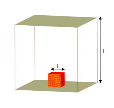

Hello
The mesh is fully symmetric and uniform.
The configuration is attached below. The obstacle is prescribed at a high temperature and concentration while the lateral walls of the cavity are at the lower values. The ceiling and bottom of the enclosure are adiabatic and impermeable. The absorption coefficient is constant for the whole medium.
