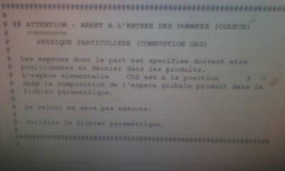

Good evening!
This is the error i had when i tried to modifie colecd
